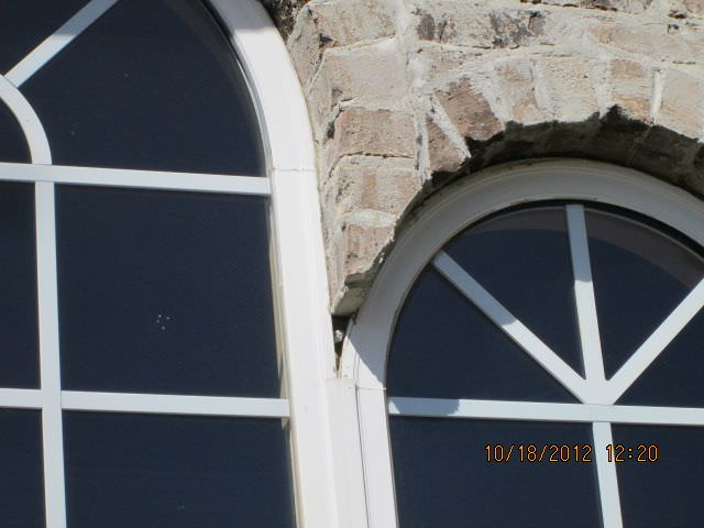

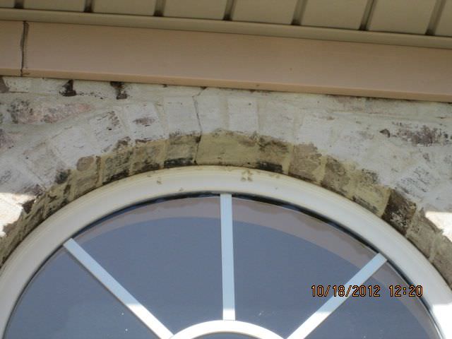

Phillip Posted October 19, 2012 Report Share Posted October 19, 2012 I known that some brick arches can support their selfs. This is not one of them Click to Enlarge 62.92 KB Click to Enlarge 48.42 KB Click to Enlarge 40.56 KB Click to Enlarge 41.89 KB Link to comment Share on other sites More sharing options...

Marc Posted October 19, 2012 Report Share Posted October 19, 2012 So what's holding it up? Mortar under tension from above? Marc Link to comment Share on other sites More sharing options...

Phillip Posted October 19, 2012 Author Report Share Posted October 19, 2012 So what's holding it up? Mortar under tension from above? Marc The window Link to comment Share on other sites More sharing options...
Nolan Kienitz Posted October 19, 2012 Report Share Posted October 19, 2012 Pity the poor window guy/company that may (someday) have to replace the windows ... for whatever reason. If he doesn't check things out closely he will have one helluva repair job. [:-bigeyes Link to comment Share on other sites More sharing options...

Tom Raymond Posted October 19, 2012 Report Share Posted October 19, 2012 Pity the poor window guy/company that may (someday) have to replace the windows ... for whatever reason. If he doesn't check things out closely he will have one helluva repair job. [:-bigeyes It won't matter. There is no head flashing visible. The whole thing will topple when the sill beneath the window rots and can't support the weight. Phillip, I am so glad you carry a camera. Link to comment Share on other sites More sharing options...
