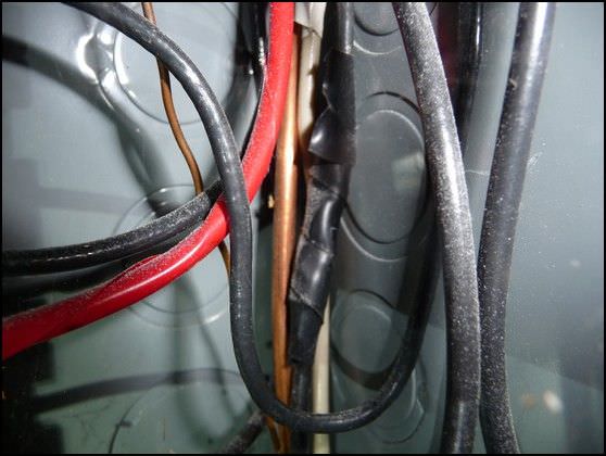

John Dirks Jr Posted November 18, 2012 Report Share Posted November 18, 2012 On todays inspection I found taped splices in the panel. I don't remember seeing this and want to make sure its incorrect before I call it. Is it possible there is a correct splice under the tape? I know that wire nuts are usually the method but I was wondering if there is another accepted method. Could the splices in the picture be ok or are they wrong? Click to Enlarge 57.84 KB Click to Enlarge 49.51 KB Click to Enlarge 43.91 KB Quote Link to comment Share on other sites More sharing options...

John Dirks Jr Posted November 18, 2012 Author Report Share Posted November 18, 2012 I think somebody used barrel crimps on those splices I pictured. I'm writing it up for further investigation and correction as needed. Quote Link to comment Share on other sites More sharing options...

John Dirks Jr Posted November 18, 2012 Author Report Share Posted November 18, 2012 Splices are permitted in panelboards long as the maximum fill is not exceeded. 312.8 Enclosures for Switches or Overcurrent Devices. Enclosures for switches or overcurrent devices shall not be used as junction boxes, auxiliary gutters, or raceways for conductors feeding through or tapping off to other switches or overcurrent devices, unless adequate space for this purpose is provided. The conductors shall not fill the wiring space at any cross section to more than 40 percent of the cross-sectional area of the space, and the conductors, splices, and taps shall not fill the wiring space at any cross section to more than 75 percent of the cross-sectional area of that space. I'm not questioning if splices are allowed in the panel. I'm questioning the method of splicing. I believe they used barrel crimps which are ok for equipment grounds but not ok for current carrying conductors. Quote Link to comment Share on other sites More sharing options...

rkenney Posted November 18, 2012 Report Share Posted November 18, 2012 Crimped connectors are allowed for wiring splices. Copallum connectors for example are the approved crimp repair for alluminum wiring. If by barrel connector you mean the cheesy crimp connector readily found at auto stores nationwide for stranded wiring, these are not suitable. In fact they only work well if you use an appropriate crimping tool properly to shape the crimp. That is the key to crimped connections: using the right tool! Crimped connectors do exist for and have long been used by electricians and code says you must use the manufacturers tool. If you want to examine every splice to verify it was done correctly go right ahead, but it is beyond the scope of a home inspection. If you suspect a problem pass it off to further inspection, but you already knew that, be prepared to explain your call. 110.14 (B) Splices. Conductors shall be spliced or joined with splicing devices identified for the use or by brazing, welding, or soldering with a fusible metal or alloy. Soldered splices shall first be spliced or joined so as to be mechanically and electrically secure without solder and then be soldered. All splices and joints and the free ends of conductors shall be covered with an insulation equivalent to that of the conductors or with an insulating device identified for the purpose. Last line says electrical tape alone will be insufficient. With taped wire nuts, the tape is not the insulator (unless its screwed up and the insulation was stripped back too far) just messy. Quote Link to comment Share on other sites More sharing options...

John Dirks Jr Posted November 18, 2012 Author Report Share Posted November 18, 2012 Crimped connectors are allowed for wiring splices. Copallum connectors for example are the approved crimp repair for alluminum wiring. If by barrel connector you mean the cheesy crimp connector readily found at auto stores nationwide for stranded wiring, these are not suitable. In fact they only work well if you use an appropriate crimping tool properly to shape the crimp. That is the key to crimped connections: using the right tool! Crimped connectors do exist for and have long been used by electricians and code says you must use the manufacturers tool. If you want to examine every splice to verify it was done correctly go right ahead, but it is beyond the scope of a home inspection. If you suspect a problem pass it off to further inspection, but you already knew that, be prepared to explain your call. I'm aware of Copallum and that my be what is under the tape. But I thought Copallum uses heat shrink insulation so why would standard tape be wrapped on them? I recently read in a Douglas Hansen book about barrel crimps designed for equipment grounds should not be used on current carrying conductors. I could quote the language but that's his copyright. Maybe he'll come along and verify that my suspicion might be correct. To be more exact, in the book he called it poor practice. Quote Link to comment Share on other sites More sharing options...
John Kogel Posted November 19, 2012 Report Share Posted November 19, 2012 I have some crimped connections in some of the outlet boxes of the 1968 parts of my house. They are small copper rings that were crimped and taped. They were ok at that time. I have replaced a few and found them all to be still tight, but the tape has dried out and is no longer secure, so they are poorly insulated. It is a judgement call, John. I imagine you've made it by now. If it looked professional, I would put a note simply that they are present, and I couldn't determine the splicing means under the tape. Quote Link to comment Share on other sites More sharing options...
John Dirks Jr Posted November 19, 2012 Author Report Share Posted November 19, 2012 Sparky was called in on many more significant issues than this. It's no big thing for him to check out these splices while he's onsite. It's in the report. Quote Link to comment Share on other sites More sharing options...
