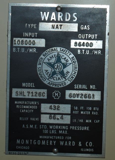

trooperchix Posted December 7, 2012 Report Share Posted December 7, 2012 Trying to figure out the age of the dinosaur that lives in my basement. I'm starting to have some issues and I would like to know what I'm doing with it. It's a hot water circulator boiler system, Model number SHL7126c. I'm hoping to score copies or original owners manuals, etc, that will help me fix my little workhorse. It states it was "manufactured for Montgomery Wards & Co". Any help would be appreciated. I have had it checked recently (2 years ago) and was told "they don't make them like this anymore" and it's a workhorse and works better than most of what is on the market today. Considering I'm broke, I'm trying to do what I can to be sure I keep it that way. Thanks. Quote Link to comment Share on other sites More sharing options...
John Kogel Posted December 7, 2012 Report Share Posted December 7, 2012 Montgomery Ward is/was a distributor. We need more info, such as a 640 X 480 picture. Any emblems, badges or labels? Quote Link to comment Share on other sites More sharing options...
trooperchix Posted December 12, 2012 Author Report Share Posted December 12, 2012 Click to Enlarge 58.51 KB Above is the identification plate. Here's a picture of the whole shebang: Click to Enlarge 45.98 KB I'm having issues and want to locate the paperwork on this dino before I start working on it. Can anyone identify it's maker? The marquee across the door says "Fairway". I know, the area has been cleaned up.. Quote Link to comment Share on other sites More sharing options...
Rob Amaral Posted December 12, 2012 Report Share Posted December 12, 2012 I'd guess 1960 era.. How old is the house? Quote Link to comment Share on other sites More sharing options...
Tom Raymond Posted December 12, 2012 Report Share Posted December 12, 2012 What issues is it having? What's readily apparent in your pic: It needs a good cleaning. The circulator wiring and conduit need repair. The make up water is turned off. I'd wager that a good bit of your trouble is related to low water. It should also have a back-flow preventer on it. Quote Link to comment Share on other sites More sharing options...
John Kogel Posted December 12, 2012 Report Share Posted December 12, 2012 The only info I can find is references to ads in newspaper archives from the 60's. I would forget about finding a paper trail and concentrate on whether it can be made safe to operate. Probably not. http://share.uppermichiganssource.com/M ... ew/2213533 Quote Link to comment Share on other sites More sharing options...

Jim Katen Posted October 21, 2015 Report Share Posted October 21, 2015 The Lost Art of Steam Heating It's a pretty big book. I'll read my copy once I retire. Marc An excellent book, but it's about steam boilers. This is a hot water boiler. Just from the color and design, I'd guess the 1960s. As long as the cast iron isn't leaking, there's no reason why you can't keep it going. Whoever told you that it was "more efficient than the vast majority of boilers on the market" was blowing smoke up your ass. Even if you could get the actual gas combustion to be more efficient (no way in hell), the transfer of heat to the water will never be as efficient as a modern boiler. But that's not really a bad thing. Very high efficiency is one of the reasons why newer boilers don't last as long as older ones. They produce acidic condensate and they have to go through all sorts of enginering gynmastics just to get the spent combustion gases outdoors. What you have there is a very simple machine. It has a simple combustion system, a simple circulating system, and not much else. If you're a mechanically inclined do-it-yourselfer, you can learn these sytems pretty easily. I suggest that you go to Dan Holohan's site, www.heatinghelp.com and noodle around there. Lots of resources and good people that can help with specific answers. Quote Link to comment Share on other sites More sharing options...
