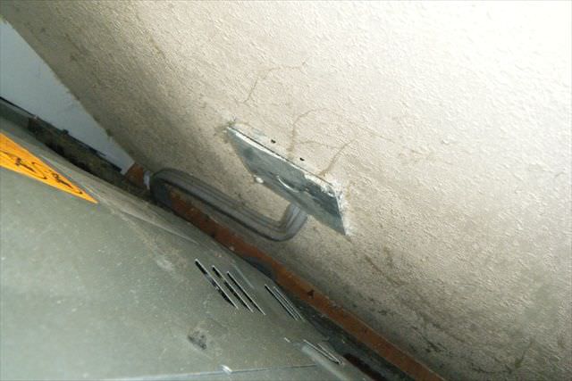

Brandon Whitmore Posted January 28, 2013 Report Share Posted January 28, 2013 This is the kitchen range wiring. It looks like someone cut the plug off and hardwired the cord. Is this allowed? My guess is no, since the cord/ plug was a listed component. I just can't recall seeing this exact installation before, and figured I'd better ask. Click to Enlarge 46.92 KB If memory serves, a range can be hardwired if proper wiring is used, the wiring is properly secured/ connected to the junction box, and if there's a lock out. Quote Link to comment Share on other sites More sharing options...
Jim Katen Posted January 28, 2013 Report Share Posted January 28, 2013 I'd say it's not allowed because the listed cord has been altered and because (as far as I know) there's no recognized method of securing the cord where it enters the box. Quote Link to comment Share on other sites More sharing options...
Richard Moore Posted January 28, 2013 Report Share Posted January 28, 2013 If memory serves, a range can be hardwired if proper wiring is used, the wiring is properly secured/ connected to the junction box, and if there's a lock out. Maybe, but wouldn't that still be ABNORMAL in a regular kitchen? Just tell them to fix it with a properly wired receptacle and a new cord-set. Who is going to argue with that? Quote Link to comment Share on other sites More sharing options...
Jim Baird Posted January 28, 2013 Report Share Posted January 28, 2013 I certainly would point out the alteration of equipment. We don't know what it looks like in that box either. Quote Link to comment Share on other sites More sharing options...
Marc Posted January 28, 2013 Report Share Posted January 28, 2013 Also, the receptacle/plug serves as a local disconnect. That's needed too. Marc Quote Link to comment Share on other sites More sharing options...

Jim Katen Posted January 28, 2013 Report Share Posted January 28, 2013 Also, the receptacle/plug serves as a local disconnect. That's needed too. Marc The local disconnect can be omitted if there's a lockout at the breaker. It's a consideration, but it wouldn't prohibit hardwiring the range. Hardwiring seems to be the rule with wall ovens, drop-in ranges, and cooktops. Quote Link to comment Share on other sites More sharing options...

Norcal Posted March 7, 2013 Report Share Posted March 7, 2013 Flexible cord cannot take the place of perm. wiring, as soon as the attachment plug is cut off & wired in, it becomes perm. wiring. Quote Link to comment Share on other sites More sharing options...
Carson2006 Posted March 7, 2013 Report Share Posted March 7, 2013 I disagree. Art. 400.7; Uses Permitted, (A)(3) connection of portable luminaires, portable and mobile signs, or appliances. (6) Connection of utilization of equipment to facilitate frequent interchange. ( Appliances where the fastening means and mechanical connections are..... etc. Pretty sure these are "permanent wiring". However, uses not permitted (1) as a substitute for the fixed wiring of a structure. i.e. branch, feeder circuits etc. Additionally, I must agree that cutting off the cord cap of said cord more than likely violates it's UL listing and is not a viable wiring method. Can't imagine why someone would want to "hardwire" a domestic range appliance--one should be able to easily pull that sucka out once in a while and clean the spilled chicken noodle soup underneath it. Quote Link to comment Share on other sites More sharing options...
Jim Port Posted March 8, 2013 Report Share Posted March 8, 2013 The stove is not going to meet the frequent interchange nor the need for a flexible connection to limit vibration. It does not satisfy 400.7. The installation as shown is wrong. Quote Link to comment Share on other sites More sharing options...
hausdok Posted March 8, 2013 Report Share Posted March 8, 2013 How could anyone possibly argue that this is an OK install? Where does it say anywhere in any code that it's OK to pinch a power cord between a box and a cover? It's a simple choice; either hard wire it with the proper materials or put a plug on the end of that cord and install a receptacle so that it can be plugged/unplugged. ONE TEAM - ONE FIGHT!!! Mike Quote Link to comment Share on other sites More sharing options...
