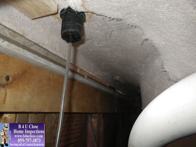

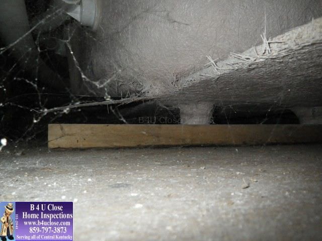

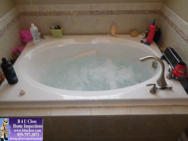

Erby Posted March 1, 2013 Report Share Posted March 1, 2013 I looked under the tub surround while waiting for the tub to fill. I saw a bunch of hair bands along the back wall. Wondering how they got there I looked a little closer. The tub stuck up above the tile surround by about 3/4" Three sides of the tub had this gap covered with wood cove trim. The back side, against the wall, was open and stuff had fallen under the tub. Looking underneath the tub, I saw that the tub was sitting on 2" x 4" boards instead of a mortar bed as I usually see. Don't the instructions for most such tubs call for a mortar bed? After I found the 2" x 4" supports, I stepped in the tub and it flexed quite a bit. Click to Enlarge 37.64 KB Click to Enlarge 54.78 KB Click to Enlarge 47.13 KB Click to Enlarge 35.3 KB Link to comment Share on other sites More sharing options...
Mike Lamb Posted March 1, 2013 Report Share Posted March 1, 2013 Don't the instructions for most such tubs call for a mortar bed? Click to Enlarge 37.64?KB Click to Enlarge 54.78?KB Click to Enlarge 47.13?KB Click to Enlarge 35.3?KB Wood can be used as long as the tub is level and supported from beneath. If it is flexing there will be a problem. Jacuzzi says mortar and foam can be used but wood can be used too. Link to comment Share on other sites More sharing options...
John Kogel Posted March 1, 2013 Report Share Posted March 1, 2013 They've glassed a sheet of OSB across the bottom of the tub and that is supposed to make it strong. A few years ago, I encountered a similar tub that had a hairline crack at the rim from the bottom sagging. I would call it an amateur (and sloppy) installation. Easy to undo what's been done there, and that's the good part. Link to comment Share on other sites More sharing options...
Erby Posted March 1, 2013 Author Report Share Posted March 1, 2013 Couldn't see it that good, but it looked to me like that OSB was glassed onto the end of the tub to support the motor and pump, not extending all the way under the tub. Link to comment Share on other sites More sharing options...
kurt Posted March 1, 2013 Report Share Posted March 1, 2013 I know wood can work, but I'd never do it. The only way I've ever seen these tubs work is when they're set in a bedding compound. Link to comment Share on other sites More sharing options...
Mike Lamb Posted March 1, 2013 Report Share Posted March 1, 2013 Most of the time you can't see beneath so I step in the tub or shower stall. If it flexes I write it up that bad things just might happen. I didn't use to do this until it came back and bit me. Link to comment Share on other sites More sharing options...
John Kogel Posted March 1, 2013 Report Share Posted March 1, 2013 Right. I've come to the realization that plumbers don't read, even if they know how. Often as not, the only thing supporting the floor of a fiberglass shower is the drain pipe. Link to comment Share on other sites More sharing options...
Scottpat Posted March 1, 2013 Report Share Posted March 1, 2013 That tub has little feet/stubs on the bottom that allow it to sit on the ground/wood or whatever. No mortar bed is needed with that type. Link to comment Share on other sites More sharing options...
