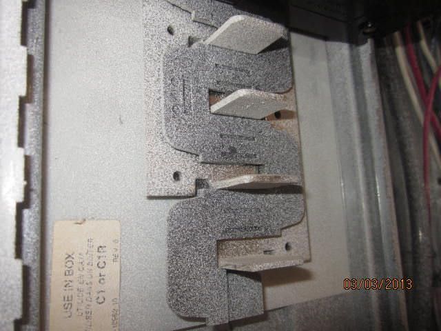

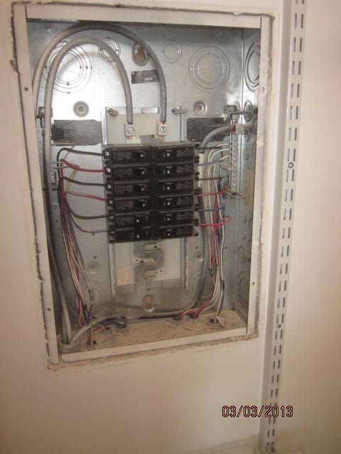

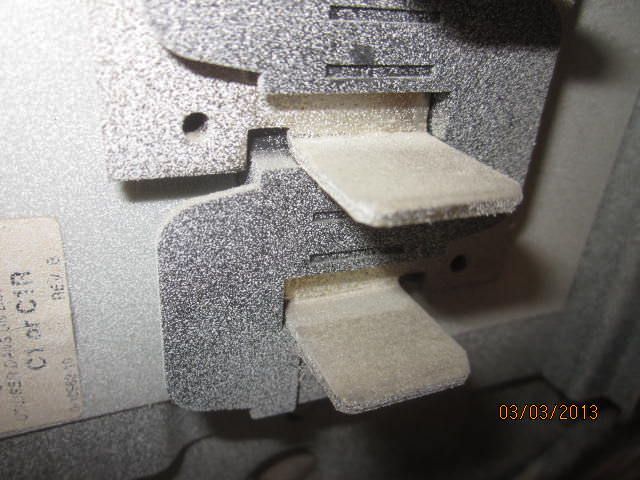

Mike Lamb Posted March 4, 2013 Report Share Posted March 4, 2013 This panel was spray painted before the breakers were installed. 110.12 © Can contaminated areas be cleaned? Would you recommend panel replacement? My main concern is the circuit breaker contact blades. Opinions? Click to Enlarge 40.32 KB Click to Enlarge 56.51 KB Click to Enlarge 59.76 KB Link to comment Share on other sites More sharing options...

Tom Raymond Posted March 4, 2013 Report Share Posted March 4, 2013 From a practical standpoint the contacts were cleaned when the breakers where installed, that's really not enough paint to impede an electrical connection at that tight fitting contact. From a home inspection perspective the panel has been contaminated and needs to be replaced. You have plenty to stand on for the call. Link to comment Share on other sites More sharing options...
Marc Posted March 4, 2013 Report Share Posted March 4, 2013 From a practical standpoint the contacts were cleaned when the breakers where installed, that's really not enough paint to impede an electrical connection at that tight fitting contact. From a home inspection perspective the panel has been contaminated and needs to be replaced. You have plenty to stand on for the call. Looking at that middle picture, there's plenty enough paint on the contact areas to cause trouble. All you need is a little resistance to start generating heat then the process begins with everything eventually goes south, ending up in your lap. Marc Link to comment Share on other sites More sharing options...

hausdok Posted March 4, 2013 Report Share Posted March 4, 2013 Hi MIke, The right call for you - the one that keeps you out of hot water and is absolutely correct - is to call for replacement. The code talks abouit "foreign contaminants" or something like that not being allowed in the panel. Look at it from a practical standpoint - even if he could to it without damaging components in the panel, how many hours is it going to take an electrician to disassemble all of that, clean it and put it back together? By the time an electrician does all of that, his fee exceeds what it would cost to install a new panel. That one isn't bad. I've seen 'em so bad that I couldn't tell what color any of the wiring was. ONE TEAM - ONE FIGHT!!! Mike Link to comment Share on other sites More sharing options...
