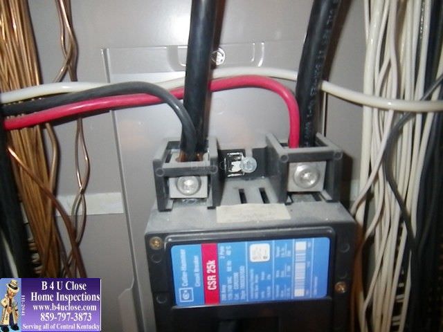

Erby Posted March 30, 2013 Report Share Posted March 30, 2013 Gee, you mean this kinda connection is sorta stupid! Click to Enlarge 54.29?KB Quote Link to comment Share on other sites More sharing options...
