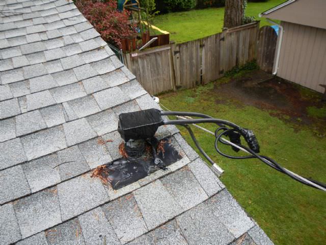

Robert Jones Posted April 20, 2013 Report Share Posted April 20, 2013 Is there a minimum height for the service mast at the roof level? Click to Enlarge 80.36 KB Quote Link to comment Share on other sites More sharing options...
Jim Katen Posted April 20, 2013 Report Share Posted April 20, 2013 I think it's a utility thing. My utility (and yours too, probably) requires the weatherhead to be 24" above the roof. Go online, find your utility and download their "Electrical Service Requirements" document. Quote Link to comment Share on other sites More sharing options...
hausdok Posted April 20, 2013 Report Share Posted April 20, 2013 Hi Rob, Per the NEC, not for the mast - only for the conductors. As Jim said, the mast height will be spec'd by the service provider. ONE TEAM - ONE FIGHT!!! Mike Quote Link to comment Share on other sites More sharing options...
