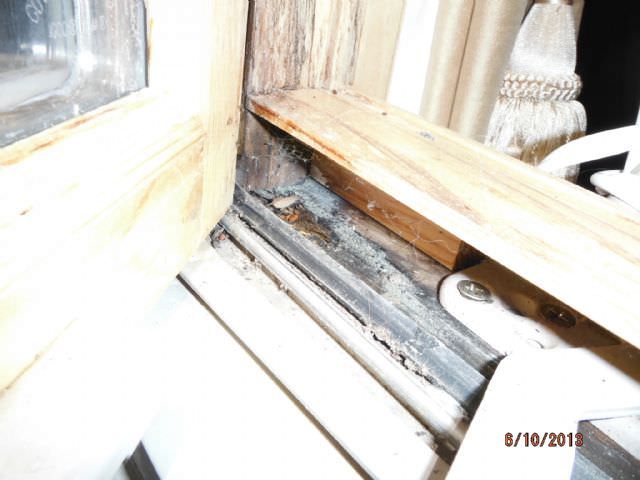

Mike Lamb Posted June 11, 2013 Report Share Posted June 11, 2013 In the late 1990s I found Norco clad casement windows less than 10 years old completely rotted out like sponges enough times to consider it epidemic. Jeld Wen bought them out in 1997. I have seen them a lot and they all looked really good until this year where I have found two different houses with the Norco casement windows rotting out after only 10 years or less. So keep a good eye out for Norco windows. Click to Enlarge 46.76 KB Click to Enlarge 43.39 KB Quote Link to comment Share on other sites More sharing options...
Steven Hockstein Posted June 11, 2013 Report Share Posted June 11, 2013 Unless the windows are pre-finished, the window reps that I know tell me that they require you to finish the windows shortly after installation or you risk voiding the warranty. In your photos it looks like the windows are still raw wood. Quote Link to comment Share on other sites More sharing options...
Stephen Lagueux Posted June 11, 2013 Report Share Posted June 11, 2013 I see them quite often here in Qc. A window pane fell off its hinges when I opened one of them last winter. Quote Link to comment Share on other sites More sharing options...
Mike Lamb Posted June 12, 2013 Author Report Share Posted June 12, 2013 Unless the windows are pre-finished, the window reps that I know tell me that they require you to finish the windows shortly after installation or you risk voiding the warranty. In your photos it looks like the windows are still raw wood. The wood you can see from inside was all varnished but the interior where the crank guts are did look like raw wood. It seems like a bad idea to count on the home owner to finish areas that can only be easily seen from outside with the window open. Quote Link to comment Share on other sites More sharing options...
Steven Hockstein Posted June 12, 2013 Report Share Posted June 12, 2013 Unless the windows are pre-finished, the window reps that I know tell me that they require you to finish the windows shortly after installation or you risk voiding the warranty. In your photos it looks like the windows are still raw wood. The wood you can see from inside was all varnished but the interior where the crank guts are did look like raw wood. It seems like a bad idea to count on the home owner to finish areas that can only be easily seen from outside with the window open. I agree. FYI-A little diversion, but in the same category. Problems like this are not unique to one manufacturer. http://www.windowsettlement.com/ (not a surprise-if you read the settlement, the real winners are the attorneys) Quote Link to comment Share on other sites More sharing options...
