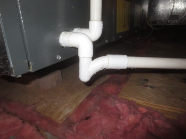

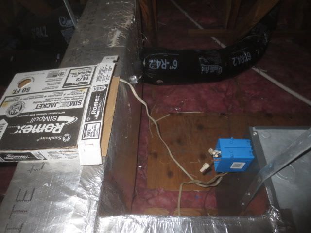

Neal Lewis Posted July 8, 2013 Report Share Posted July 8, 2013 Brand new A/C install. What kind of trap is this for the condensate line? Never seen it before. I know it's not correct. No overflow pan and lots of other problems. This system is very messed up. The wiring for the missing shut off switch is still connected to the coiled up Romex still in the box. Strange. Click to Enlarge 44.95 KB Click to Enlarge 27.2 KB Quote Link to comment Share on other sites More sharing options...
Jim Katen Posted July 8, 2013 Report Share Posted July 8, 2013 The trap might be the only thing that is correct. To know for sure, you'd have to look at the manufactuer's instructions, which will tell you how deep the trap needs to be depending on the static pressure of the blower. The trap itself is made by Lasco: http://www.lowes.com/ProductDisplay?par ... &cId=PDIO1 Quote Link to comment Share on other sites More sharing options...
