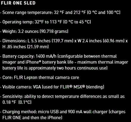

Charles46 Posted January 8, 2014 Report Share Posted January 8, 2014 Here are a few spec's from the Flir site Click to Enlarge 18.79 KB Quote Link to comment Share on other sites More sharing options...
Marc Posted January 8, 2014 Report Share Posted January 8, 2014 Hey Marc. Would you describe that thing as a picayune piece of equipment? [] Given the specs Charles has posted, it doesn't yet reach the value of half a picayune. The picayune itself is half a coin. Marc Quote Link to comment Share on other sites More sharing options...
