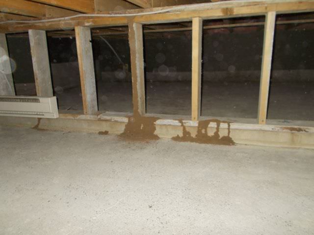

John Kogel Posted January 12, 2014 Report Share Posted January 12, 2014 Subterraneans are kind of rare on Vancouver Island. We have more of the Dampwood termites that attack wood that is already rotting. So I was a bit surprised to find these mud tubes in the middle a dry 5 year old crawlspace. There is a shrinkage crack between the concrete skim coat and the footing. I wonder if there is an old log or stump under the house. There are no signs of termites around the exterior foundation. Just this one attack. They found a crack between the top plates of the stud wall. Click to Enlarge 43.43 KB Click to Enlarge 45.82 KB Click to Enlarge 46.57 KB Quote Link to comment Share on other sites More sharing options...
inspector57 Posted January 12, 2014 Report Share Posted January 12, 2014 I'm not a pest control guy, but that looks like a VERY large colony. I would be looking for lots of hidden damage. Is a soil termiticide pretreatment not required in your area? Quote Link to comment Share on other sites More sharing options...
John Kogel Posted January 12, 2014 Author Report Share Posted January 12, 2014 I'm not a pest control guy, but that looks like a VERY large colony. I would be looking for lots of hidden damage. Is a soil termiticide pretreatment not required in your area? Nope. Subterranean termite attacks are rare, so there's no real need for treatment as a rule. Quote Link to comment Share on other sites More sharing options...
ghentjr Posted January 12, 2014 Report Share Posted January 12, 2014 As a licensed supervisor pest control guy I think your statement does not make sense. They are there, they got there, they did and are doing their thing and I would venture based on the size of mud they have swarmed a number of times. Subs have been found in northern areas of Canada and VC has more moderate temps so no reason they would not survive there. Quote Link to comment Share on other sites More sharing options...

Rob Amaral Posted January 13, 2014 Report Share Posted January 13, 2014 That strip of electric heat was one of the inviting reasons.. .. Quote Link to comment Share on other sites More sharing options...
John Kogel Posted January 13, 2014 Author Report Share Posted January 13, 2014 That strip of electric heat was one of the inviting reasons.. .. Thanks, Rob. That is a common setup here for newer crawlspaces; Concrete floor, perimeter insulation and a baseboard heater or two, hopefully with a thermostat near the hatch. A lot of home owners have never touched the control since they moved in. Sometimes they are cranked on full, but quite often the seller has left the heat turned off to save money. Anyway, I love these crawls, especially when there is a clean strip of carpet to lay on. Are you saying that subs are attracted to heat? I know ants like a warm nest, didn't know that about termites, but saw the mud tube here from the dirt to the heater, which was on. Quote Link to comment Share on other sites More sharing options...
ghentjr Posted January 14, 2014 Report Share Posted January 14, 2014 Warm and humid is what subs like. Plus a food source, of course. Quote Link to comment Share on other sites More sharing options...
