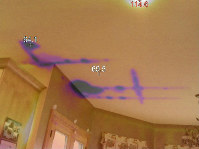

mark parlee Posted August 18, 2015 Report Share Posted August 18, 2015 Just Sold my FLIR T420 and got a Fluke Tix520 in my hands. Pretty nice camera but I think the Ti560 is probably a little better. Here are a couple of pictures. This one also has the super resolution option available Click to Enlarge 28.61 KB Click to Enlarge 27.36 KB Quote Link to comment Share on other sites More sharing options...
