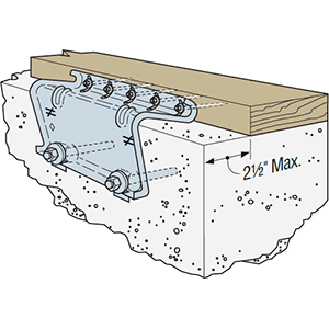

mcyr Posted November 30, 2014 Report Share Posted November 30, 2014 If you are afraid that the house will fly away, you might want to think of using Simpson's UFP 10-SDS3. Click to Enlarge 26.73 KB Quote Link to comment Share on other sites More sharing options...
mjr6550 Posted November 30, 2014 Report Share Posted November 30, 2014 I would probably use steel straps attached to the joists and to the foundation wall if the main concern was uplift. If also concerned about inward movement of the foundation walls then the steel angle approach is better, but the leg of the angle bolted to the foundation wall needs to be long enough to meet edge distance requirements for the fasteners. Quote Link to comment Share on other sites More sharing options...
