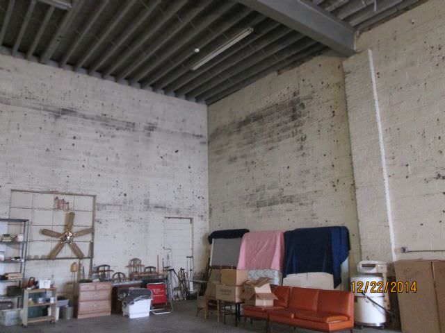

allseason Posted December 23, 2014 Report Share Posted December 23, 2014 I was in a commercial/warehouse today, concrete block and brick. One section date unknown but the owner has been in business 70 yrs. The other half built in the 1970's. The block walls in the older section have a lot of small divets, most appear to be from the interior face of the block, not from fasteners or mechanical damage for the most part. I have seen in some old block where iron in the aggregate will rust and pop small spots. Any ideas? This side of the building was also the victim of a fire at some point, likely prior to the 1970's addition as that is unscathed. Could that have affected the block? Otherwise the walls are plumb and solid, very few cracks. Click to Enlarge 44.95 KB Click to Enlarge 48.91 KB Quote Link to comment Share on other sites More sharing options...

mjr6550 Posted December 23, 2014 Report Share Posted December 23, 2014 It could very well be iron deposits. I see that often in old block. Concrete based products can spall when exposed to fire because the concrete contains water that can turn to steam and build up pressure. Quote Link to comment Share on other sites More sharing options...

ghentjr Posted December 23, 2014 Report Share Posted December 23, 2014 The blocks were made from leftover cinders (cinder block) from incinerators. Leftover organic matter, over time, "popped" the block from the creation of small pockets of methane gas. A very common thing in CT especially around the Bridgeport area but I assume it occurs anywhere cinders were used to make block. Quote Link to comment Share on other sites More sharing options...
Jim Baird Posted December 23, 2014 Report Share Posted December 23, 2014 I agree with the cinders theory. I had a guy bring coal cinders from a big coalfired heating plant to put on my driveway because he got them for no cost. They are often light and airy and could well be like sponges when mixed in the block making slurry. The only other thing that occurred to me was bullet holes. Don't suppose there could ever have some tommy-gun firing sessions there? Quote Link to comment Share on other sites More sharing options...

allseason Posted December 23, 2014 Author Report Share Posted December 23, 2014 There are areas where rust stains are present below the holes that leads me to the iron. When one of my brothers ran track in high school he ran on cinder covered tracks. Quote Link to comment Share on other sites More sharing options...

hausdok Posted December 24, 2014 Report Share Posted December 24, 2014 The heat from the fire did it. I've seen the face of concrete blocks spall in many a fire pit once exposed to heat. Sometimes the divots pop off with a lot of force and send embers up into the air and scare the crap out of everyone. ONE TEAM - ONE FIGHT!!! Mike Quote Link to comment Share on other sites More sharing options...
