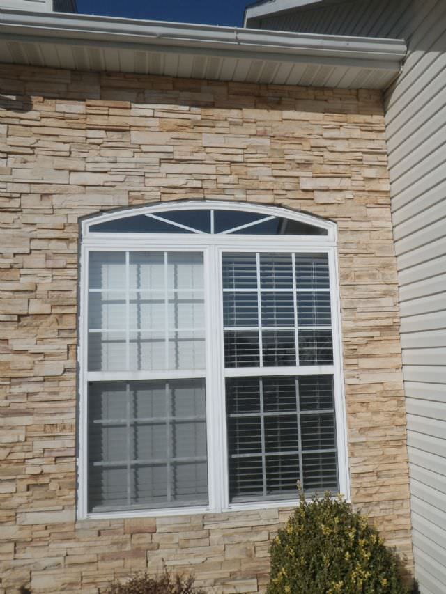

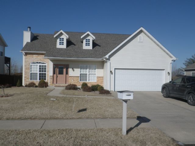

Mark P Posted March 8, 2015 Report Share Posted March 8, 2015 Anyone have a real world picture of what a weep screen looks like? Is it normally visible along the bottom edge of AMSV over wood framing? I had a house yesterday with this material over a small area on the front. I'm not sure if there is a weep screen or not. I'm not really sure what I'm looking for or if it would be visible anyway. I used an infrared camera and moisture meter on the inside and found no hidden problems. Also if someone would like to share a general boiler plate regarding AMSV. Something that speaks to the history of installation problems, etc. Thanks Click to Enlarge 41.53 KB Click to Enlarge 104.76 KB Click to Enlarge 59 KB Quote Link to comment Share on other sites More sharing options...
kurt Posted March 8, 2015 Report Share Posted March 8, 2015 Screed. Weep screed. The crappy ones look like drywall j channel. They're on the "back" facing the wall. The j channel stuff is kinda crappy. We use a custom channel from a CNC sheet metal shop that's got a "kick" at the bottom to deflect the water out away from the wall. (For stucco, not AMCV). Quote Link to comment Share on other sites More sharing options...
