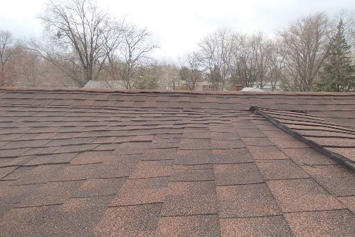

mjr6550 Posted April 18, 2015 Report Share Posted April 18, 2015 I think this was the most unique valley I have ever seen. This was a recently completed addition. Many other things were just as bad. Click to Enlarge 52.56 KB Click to Enlarge 47 KB Click to Enlarge 47.12 KB Click to Enlarge 48 KB Quote Link to comment Share on other sites More sharing options...
Jim Baird Posted April 18, 2015 Report Share Posted April 18, 2015 ...grammar police remind us that "unique" means "one-of-a-kind", ergo has no qualifiers, no mores or lesses. Re the valley, it is so subtle. The roofer had to be very intuitive in his shingle direction. Don't suppose it might leak above that camelback in the middle. Quote Link to comment Share on other sites More sharing options...
kurt Posted April 18, 2015 Report Share Posted April 18, 2015 I got vertigo looking at it. Quote Link to comment Share on other sites More sharing options...
Tom Raymond Posted April 18, 2015 Report Share Posted April 18, 2015 Do you know how to get a roofer to warranty that valley? Unique up on him. Quote Link to comment Share on other sites More sharing options...
Erby Posted April 19, 2015 Report Share Posted April 19, 2015 Didn't think you were supposed to weave the thicker shingles? Quote Link to comment Share on other sites More sharing options...
John Kogel Posted April 19, 2015 Report Share Posted April 19, 2015 That would leak here. Not enough slope either. Quote Link to comment Share on other sites More sharing options...
Rob Amaral Posted April 20, 2015 Report Share Posted April 20, 2015 You know, it's nice to know that morons are at work all over the US... .. Quote Link to comment Share on other sites More sharing options...
Mike Lamb Posted April 20, 2015 Report Share Posted April 20, 2015 This might be OK if everything beneath has an ice and water shield. Any signs of leaks? Quote Link to comment Share on other sites More sharing options...

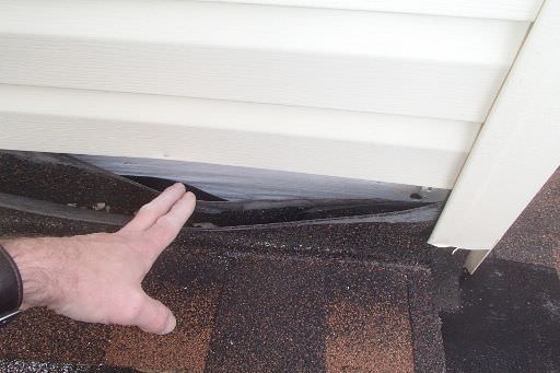

mjr6550 Posted April 21, 2015 Author Report Share Posted April 21, 2015 There are no signs of leaks, but it is only about 1 year old and this roof was framed over the main roof. The whole thing needs to come off. The story is that the original contractor did so many things wrong on the addition (including putting asphalt shingles on an about 1:12 pitch roof on another part of the addition) that he was kicked off the job. The owner hired Lowes to finish the addition and they agreed to make any necessary corrections. They seem to have only added to the problems. Here is another fine detail from the same house. Click to Enlarge 34.62 KB Click to Enlarge 32.32 KB Quote Link to comment Share on other sites More sharing options...
