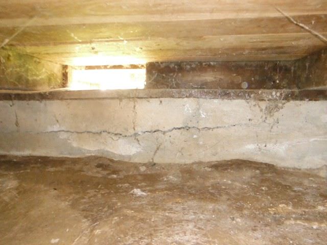

Denray Posted May 2, 2015 Report Share Posted May 2, 2015 This is from a 70's do it yourself for a cabin in the woods. The horizontal cracks look very jagged. Displaced a bit at the exterior, but not so much in the crawl. Think it's just from a poor second pour?? Click to Enlarge 52.26 KB Click to Enlarge 57.28 KB Quote Link to comment Share on other sites More sharing options...

Jim Katen Posted May 2, 2015 Report Share Posted May 2, 2015 That first picture looks like the concrete moved after it was placed, but before it set. Almost as if someone backed his truck into the forms after the pour. Quote Link to comment Share on other sites More sharing options...
kurt Posted May 2, 2015 Report Share Posted May 2, 2015 The explanation is in the first sentence. It's a 70's DIY cabin. Some hippie was smoking some Humboldt bud and making a mess of things. My bet is somewhere around Katen's.....someone mashed the foundation, or the forms blew out, or......pass the bong.....I gotta think about this a second...... Quote Link to comment Share on other sites More sharing options...

mjr6550 Posted May 2, 2015 Report Share Posted May 2, 2015 To me it looks like the concrete expanded. If not corrosion of rebar it could be a reaction with the aggregate. The fact that it is a single line may relate to a cold joint. If its only happening at one location it is probably not a big concern. Quote Link to comment Share on other sites More sharing options...

Jim Katen Posted May 2, 2015 Report Share Posted May 2, 2015 If you look carefully at the first picture, the crack begins and ends in the middle of the concrete, with no other cracks radiating from it. The concrete had to have been plastic when that crack formed. I've had forms blow out during pours and as the mass of concrete starts to slump, it can create cracks just like that. Quote Link to comment Share on other sites More sharing options...

tom2tone Posted May 18, 2015 Report Share Posted May 18, 2015 Is the "crack'' an actual crack or a cold joint where a second pour was placed on top? Where is the cabin located and how deep is the footing. In very cold climates where the footing is not below the frost line, all kinds of things can happen. Are there gutters on the cabin leading the rainwater away from the foundation? I would also check the bottom wall plates to look for displacement, as well as checking the floors and walls for movement. It is rare that you would find any rebar in that wall, it would likely only be in the footing. It's hard to determine the cause without a visual inspection. Quote Link to comment Share on other sites More sharing options...
