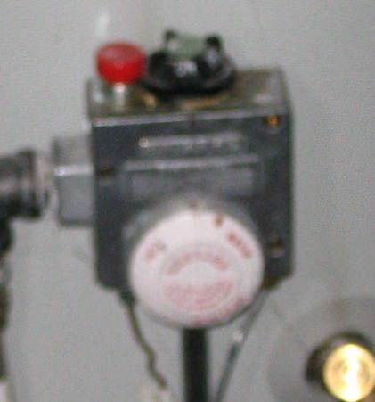

Richard Moore Posted November 27, 2005 Report Share Posted November 27, 2005 I had around 148F water temp today, measured at various places, different times. Normally I would expect the thermostat to be turned way up at the water heater, but this one was at the "factory setting" mark, closer to Warm than Hot. (sorry, the photo is out of focus) Download Attachment: 0022x.jpg 36.37 KB The water was definately "scalding" and I've checked my thermometer. I'm not comfortable that the clients will be able to turn this down enough to a safe temperature, especially with a 3-year old, so I'm calling for repair. Water heater is a June, 2001 Bradford White MI403S6EN12 with what looks like a Robert-Shaw control. The recall for those shouldn't affect a 2001 valve. It's a first for me. Anyone seen this before or know of an existing problem? Quote Link to comment Share on other sites More sharing options...
Brian G Posted November 28, 2005 Report Share Posted November 28, 2005 Not me, when I find really hot water the thermostat is always up. My last job had it maxed out...first time I've seen one wide open. I'd ring the alarm too. That sounds unsafe and potentially dangerous. Brian G. There's Hot, And Then There's HOT!!! [:-hot] Quote Link to comment Share on other sites More sharing options...
paul burrell Posted November 28, 2005 Report Share Posted November 28, 2005 I find water heater therms set on hot as high as possible. The occupants think that they get more hot water this way. Not so the volume is the same they just get scalded. I explain this to them and they seem to know what I am talking about but sometimes I don't think they really do. Paul Burrell Quote Link to comment Share on other sites More sharing options...
Paul MacLean Posted November 28, 2005 Report Share Posted November 28, 2005 Richard, I recently had the same experience you did...extremely hot water at what looked like normal water heater controls settings. I tried to adjust the setting by turning it up to "Very Hot" and the burner would not light indicating a problem with the control. I reported the scalding water and recommended repair. Unfortunately I did not record the brand of water heater. Quote Link to comment Share on other sites More sharing options...
Les Posted November 28, 2005 Report Share Posted November 28, 2005 We find this condition often in a particular geographic area that has high sediments in their well water. The probe gets coated with scale and seems to have the reverse effect; low setting = high temp. I would have called it and would have expected "my" inspector to do the same if I was the buyer. Quote Link to comment Share on other sites More sharing options...
Richard Moore Posted November 28, 2005 Author Report Share Posted November 28, 2005 Thanks guys, Seems like it's just a "rogue" thermostat rather than a common problem. Anyway...client was made very aware of the potential hazard on site and in the report so I have no doubt this will get fixed promptly. Quote Link to comment Share on other sites More sharing options...
