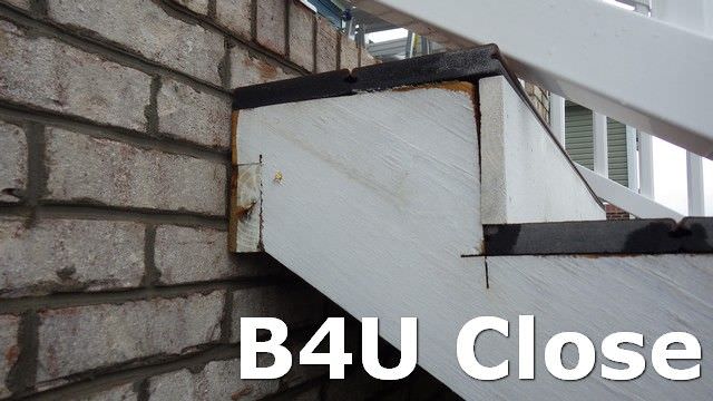

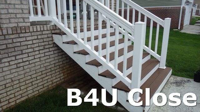

Erby Posted July 17, 2015 Report Share Posted July 17, 2015 What do y'all think about front steps being supported by a 2x4 screwed to the brick? No signs of it being secured to the concrete at the bottom. Yes, I know they cut the stringer ugly. Click to Enlarge 62.35 KB Click to Enlarge 48.42 KB Click to Enlarge 41.74 KB Link to comment Share on other sites More sharing options...

inspector57 Posted July 17, 2015 Report Share Posted July 17, 2015 Is it brick veneer or solid? As you know, brick veneer is not a structural element, so I would not be happy if it is veneer. Link to comment Share on other sites More sharing options...
Marc Posted July 17, 2015 Report Share Posted July 17, 2015 If it's a veneer: The steps are supported at the top by brickwork. This brickwork is intended as a cosmetic item only and isn't thick enough to absorb structural loads. You should install a couple posts between the slab and the ledger (that 2X4 screwed into the brickwork) to take the load off of the brick before it cracks. Marc Link to comment Share on other sites More sharing options...
Chad Fabry Posted July 17, 2015 Report Share Posted July 17, 2015 Tap Cons are not a rated fastener for structural connections. Link to comment Share on other sites More sharing options...
John Kogel Posted July 17, 2015 Report Share Posted July 17, 2015 Besides all of the above, the wood isn't even painted. Link to comment Share on other sites More sharing options...
