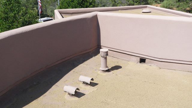

JPLomeo Posted August 16, 2015 Report Share Posted August 16, 2015 Hi All, Need some suggestions on this one. Saw a gas fired water heater vent on a flat roof today that was too close to a parapet wall. Looked like a regular B vent and I would typically write that up. When I got to the water heater, it had a fan assisted draft system with no open draft hood. Being that the termination is just a regular B type vent, do the usual rules still apply- two feet higher than any wall within 8 feet ? The rules for forced air draft systems do not seem to address vertical walls near the vent termination. I would think that a strong wind coming off that parapet wall top would still create a vortex and mess with the draft, fan or no fan. Thanks JP Click to Enlarge 37.05 KB Quote Link to comment Share on other sites More sharing options...

JPLomeo Posted August 17, 2015 Author Report Share Posted August 17, 2015 Hi, Thanks for the reply but, yes there is a rule: B or L vent termination within 8 feet of a wall or roof obstruction must be 2 feet higher (per IRC 2427.6.4 and UMC 802.6.2-thanks to "Code check"). Here in AZ we have lots of flat roofs with parapets and often find an incorrect installation. What's got me stumped is that this has a forced draft fan into a B vent and that's not typical. I've got to send the report out tonight and I'm sticking with my opinion that this is not quite right. I'll have to defer to a licensed plumber to evaluate and repair :-C Quote Link to comment Share on other sites More sharing options...
Marc Posted August 17, 2015 Report Share Posted August 17, 2015 ...What's got me stumped is that this has a forced draft fan into a B vent and that's not typical... Maybe because it isn't supposed to be a B vent. Manufacturer's installation specs trumps Code. Marc Quote Link to comment Share on other sites More sharing options...
inspector57 Posted August 17, 2015 Report Share Posted August 17, 2015 Just because it has a fan assist does not change the type of vent, it is still technically not a positive pressure vent such as you would have with a unit using PVC. Various gas-fired appliances, which are required to be vented, are categorized for the purpose of vent selection into four categories (Categories I, II, III, and IV), based on their vent static pressure (non-positive or positive) and whether the vent gas conditions avoids or may cause excessive condensate production in the vent. http://ul.com/wp-content/uploads/2014/0 ... liance.pdf IF it correctly uses b vent pipe, then it falls under the b vent rules unless the manufacturer stipulates a more restrictive rule in their installation manual. Quote Link to comment Share on other sites More sharing options...
mjr6550 Posted August 18, 2015 Report Share Posted August 18, 2015 Hi, Thanks for the reply but, yes there is a rule: B or L vent termination within 8 feet of a wall or roof obstruction must be 2 feet higher (per IRC 2427.6.4 and UMC 802.6.2-thanks to "Code check"). Here in AZ we have lots of flat roofs with parapets and often find an incorrect installation. What's got me stumped is that this has a forced draft fan into a B vent and that's not typical. I've got to send the report out tonight and I'm sticking with my opinion that this is not quite right. I'll have to defer to a licensed plumber to evaluate and repair :-C You are correct where there is a wall within 8 feet. I really never see that case since almost every B-vent I see is in a sloped roof, where the height is based upon roof slope. Unlike fan assisted furnaces that still rely on chimney draft, all of the fan assisted water heaters I see are positive pressure and should not vent to a B-vent. Quote Link to comment Share on other sites More sharing options...
inspector57 Posted August 18, 2015 Report Share Posted August 18, 2015 Here is one from Rheem that is induced draft rated for use with b-vent.http://www.rheem.com/product/residentia ... uced-draft Bottom line is you have to check out the instructions to be sure they used the correct vent pipe. Quote Link to comment Share on other sites More sharing options...
mjr6550 Posted August 19, 2015 Report Share Posted August 19, 2015 Here is one from Rheem that is induced draft rated for use with b-vent.http://www.rheem.com/product/residentia ... uced-draft Bottom line is you have to check out the instructions to be sure they used the correct vent pipe. That's a new one for me. Quote Link to comment Share on other sites More sharing options...
Marc Posted August 19, 2015 Report Share Posted August 19, 2015 I guess 'B' vents are allowed on induced draft appliances as long as they're not condensing types. In all my years as a contractor and now as HI, I've only seen one condensing appliance with my own eyes. Marc Quote Link to comment Share on other sites More sharing options...
