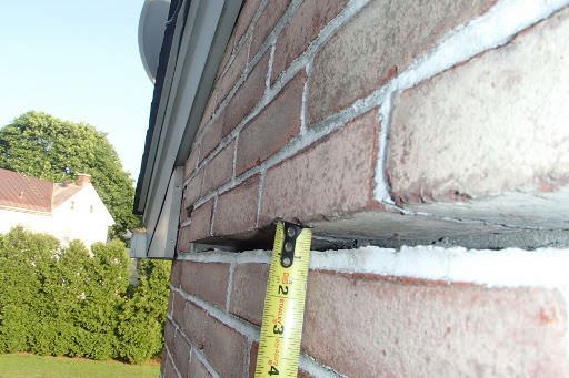

mjr6550 Posted September 4, 2015 Report Share Posted September 4, 2015 A little while ago I did a brief visual structural inspection as a favor to a contractor. The building was built in 1975. The construction is brick over concrete block. As you can see from the photos, there has been excessive cracking and displacement due to corrosion of the steel lintels. Any ideas as to why this is worse than typical for the age? The lack of flashing and weep holes is obvious, but that is typical around here. Looks like the lintels were never painted, but I've seen that before without excessive corrosion. Looking at the clean separation between the mortar joints and brick makes me thing there was a lack of suction, so maybe hairline cracks? The condition is worse on the northern exposure, but I would expect that. One other factor of interest. There is a small concrete/concrete block manufacturer to the north less than 1/4 mile away. I'm not sure whether that could have much effect on atmospheric corrosion. Click to Enlarge 46.23 KB Click to Enlarge 42.67 KB Click to Enlarge 44.67 KB Click to Enlarge 47.76 KB Click to Enlarge 45.19 KB Quote Link to comment Share on other sites More sharing options...
kurt Posted September 4, 2015 Report Share Posted September 4, 2015 I find variance in steel quality. Could be as simple as really crappy steel. Wet masonry and cheap steel = lots of rust and delam. Quote Link to comment Share on other sites More sharing options...
mjr6550 Posted September 4, 2015 Author Report Share Posted September 4, 2015 I thought about that, but I have not looked into quality of steel versus corrosion. I believe I googled that before and did not get far. I'll try again. Quote Link to comment Share on other sites More sharing options...
kurt Posted September 4, 2015 Report Share Posted September 4, 2015 I look at lintels all day, all year. I notice big differences in corrosion rates with little no difference in building type, age, or construction. I see some really old stuff that's >100 years old, and it's fine. It's the bluish stuff, meaning there's a lot of chrome in there. I can imagine some mid 70's steel being really crappy. Quote Link to comment Share on other sites More sharing options...
mlparham Posted September 4, 2015 Report Share Posted September 4, 2015 Most of the steel used for modern lintels is most likely a 1020 steel hot rolled product. The primary difference between the products you encounter is the surface treatment of the steel and the installation of the wall flashing. You can purchase galvanized steel lintels but I rarely see them in my market. Stainless steel angle is also available. If the flashing is screwed the only thing that will stand up to the water intrusion is stainless steel. If the water intrusion is that bad you have other problems. Quote Link to comment Share on other sites More sharing options...
kurt Posted September 4, 2015 Report Share Posted September 4, 2015 That sounds good, but what about the buildings that have no flashing and no corrosion, and the one's that have flashing and major corrosion? And every combination in between? Are you saying that all steel is the same quality? Maybe, because there's no way for me to know differences in steel, but some stuff goes to blazes and some doesn't and there's no apparent condition that separates the two. Why? Quote Link to comment Share on other sites More sharing options...

Steven Hockstein Posted September 5, 2015 Report Share Posted September 5, 2015 There could be a correlation between corrosion and the chemicals within the mortar and/or bricks. There may even even be some salt in the sand that was used in the mortar mix. Over the years the chemicals washing out can impact the steel. Quote Link to comment Share on other sites More sharing options...
kurt Posted September 5, 2015 Report Share Posted September 5, 2015 I think there's a correlation like you describe. Certainly. So, nobody's going for differing grades of steel? It's all the same stuff? Quote Link to comment Share on other sites More sharing options...
Scottpat Posted September 6, 2015 Report Share Posted September 6, 2015 I think there's a correlation like you describe. Certainly. So, nobody's going for differing grades of steel? It's all the same stuff? Yes the grades differ as well as the production methods.. Just like colors differ with dye lots for pretty much everything made. If you have ever been in a steel plant,it is amazing how they mix the molten steel with additives. They toss in this and that with a little more of this until they get what they think is the proper mix. Yes it is now confirmed by a chemical analysis now, but the mix will still differ mill to mill. Quote Link to comment Share on other sites More sharing options...
Steven Hockstein Posted September 6, 2015 Report Share Posted September 6, 2015 I think there's a correlation like you describe. Certainly. So, nobody's going for differing grades of steel? It's all the same stuff? There are certainly different grades of steel and different reasons why the steel corrodes. Most of us don't have the ability to know why the steel goes bad. We can just make educated guesses. I did not intend to imply that your guess was any worse than mine. Quote Link to comment Share on other sites More sharing options...
kurt Posted September 6, 2015 Report Share Posted September 6, 2015 I know. I wasn't saying that. I see such huge variance in just about everything from mortar to brick to wood....I just think there's varying grades of steel that we aren't even aware of. What Scott describes is why I have this idea; it's like baking a cake. They toss stuff in and make educated guesses mid recipe. I was first alerted to this years ago when I was reading some old spec's for buildings. The architects and engineers back then would specify the grade of steel in the nice places. Quote Link to comment Share on other sites More sharing options...
mlparham Posted September 6, 2015 Report Share Posted September 6, 2015 I have spent a number of years as a forensic metallurgical engineer in my life. The number of reasons that steel corrosion occurs are endless. Each individual case of excessive corrosion must be evaluated on its own history. One should not try to make a general observation that encompasses all steel corrosion. The corrosion could be caused by stray electrical currents, variations in steel composition, as Steven suggested, the composition of adjacent materials and even to the air that the steel is exposed. Quote Link to comment Share on other sites More sharing options...
kurt Posted September 6, 2015 Report Share Posted September 6, 2015 I wish I could hire you as mentor. I look at steel lintels all day every day. I'd love to develop some guidelines in how to think about this. Quote Link to comment Share on other sites More sharing options...
mlparham Posted September 6, 2015 Report Share Posted September 6, 2015 I wish I could hire you as mentor. I look at steel lintels all day every day. I'd love to develop some guidelines in how to think about this. If you have access to a mass spectrometer for chemical analysis, a scanning electron microscope for fracture analysis and a metallurgical lab equipped for processing specimens for microscopic analysis it would be my please to serve you. Quote Link to comment Share on other sites More sharing options...
mjr6550 Posted September 7, 2015 Author Report Share Posted September 7, 2015 Kurt, I suspect that there are differences in steel that would explain the different rates of corrosion, but I did search quite a bit and could not find much good info on the topic. I found some references to increased amounts of manganese causing more corrosion. Manganese is added to hot rolled steel, so that is a possibility. I was leaning towards poor brickwork because of the age and the complete lack of mortar residue at the horizontal joint that separated. Quote Link to comment Share on other sites More sharing options...
