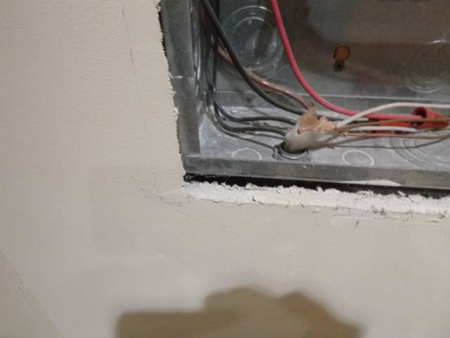

John Dirks Jr Posted December 7, 2015 Report Share Posted December 7, 2015 I write up improper panel screws all the time. Here is the first case that I found out why. Incidentally, this panel had been installed flush with the studs and then the drywall was installed after the fact creating the excessive setback. That's why the proper screws which were too short as a result would not work. Click to Enlarge 52.94 KB Click to Enlarge 32.42 KB Link to comment Share on other sites More sharing options...

John Dirks Jr Posted December 7, 2015 Author Report Share Posted December 7, 2015 You write up the fire hazard too? Marc For the panel mounting depth, I absolutely write it up. I also find it alot at receptacles. Especially in flips where they put drywall over drywall and don't use box extenders. Link to comment Share on other sites More sharing options...

John Dirks Jr Posted January 13, 2016 Author Report Share Posted January 13, 2016 Am I the only one who carries a bag of spare panel cover screws? Haven't written up sharp screws in the last few decades. What if there is damaged conductor insulation as a result of improper screws. Are you fully confident you catch all of that? How about when the screw hole is reamed and won't accept the screw that is designed for the particular panel? What do you do then? Link to comment Share on other sites More sharing options...
Jim Katen Posted January 13, 2016 Report Share Posted January 13, 2016 Am I the only one who carries a bag of spare panel cover screws? Haven't written up sharp screws in the last few decades. What if there is damaged conductor insulation as a result of improper screws. Are you fully confident you catch all of that? How about when the screw hole is reamed and won't accept the screw that is designed for the particular panel? What do you do then? If there's a damaged conductor, then there's a damaged conductor and I report that. I'm 100% confident that I catch those - isn't looking for damaged conductors near the screw holes one of the most basic things that you look for when you open a panel, even when the screws aren't sharp? It's probably the first thing I look for. If the screw hole is damaged, then I report that. But most of the time, the proper screw threads itself in there just fine. Carrying spare screws doesn't solve all of the problems associated with sharp screws, but it saves me from putting the sharp screws back in and it saves me from reporting them. Link to comment Share on other sites More sharing options...
