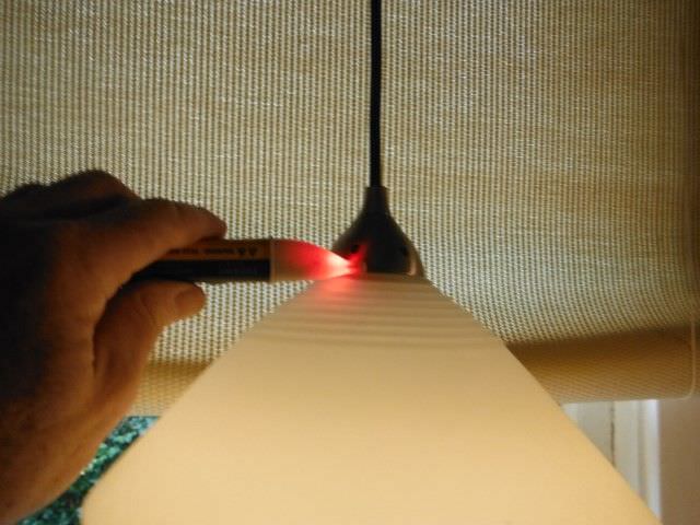

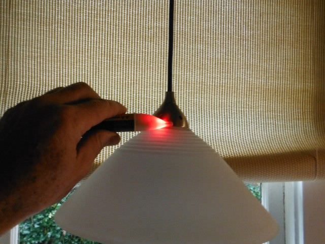

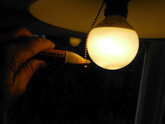

Denray Posted January 15, 2016 Report Share Posted January 15, 2016 Light over sink. Sniff lights up when light on or off when touching metal above bulb. Lights up when light on and touching the pull chain. Light working off wall switch also. Whatcha think? Click to Enlarge 25.64 KB Click to Enlarge 63.57 KB Click to Enlarge 56.03 KB Click to Enlarge 23.04 KB Lots of non grounded wiring in this unit. Link to comment Share on other sites More sharing options...
Marc Posted January 15, 2016 Report Share Posted January 15, 2016 Could be a shock hazard but it could be just a little capacitive coupling too, which is unlikely to shock enough to feel anything. Them sniffers are so sensitive, they can mislead. Carry a squiggy alongside the sniffer. Marc Link to comment Share on other sites More sharing options...

mjr6550 Posted January 16, 2016 Report Share Posted January 16, 2016 If it lights up with the wall switch off (I'm not sure if you meant that) then likely switch is on the neutral conductor. Link to comment Share on other sites More sharing options...
