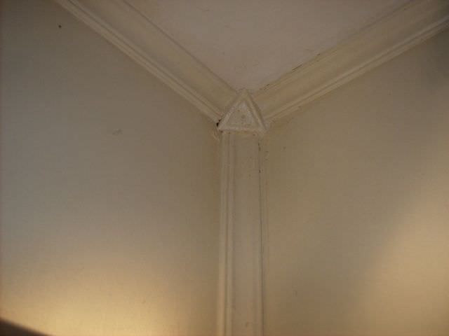

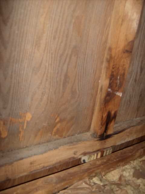

Jim Baird Posted May 17, 2016 Report Share Posted May 17, 2016 I stumbled across a curious modular dwelling from 1950's. I think I have it pegged as a Gunnison brand. It has interesting trusses, 2X3 studs, and interior wall panels that are thin and almost feel like laminate with paint. Interior ceiling and corner trim had a curious continuity. Windows all steel casement and awning. Anyone here know these? The first is not my image but the second is, of the inside trim. Click to Enlarge 14.5 KB Click to Enlarge 16.1 KB Quote Link to comment Share on other sites More sharing options...
Bill Kibbel Posted May 17, 2016 Report Share Posted May 17, 2016 I used to cover an area in SE PA that US Steel spent $50 million constructing Gunnison Homes in Fairless Hills near the steel plant. (at that time Benjamin Fairless was the pres. of US steel and US Steel bought Gunnison Homes) The exterior walls aren't 2x3s. The prefab panels would look like 2x4s laid flat in a grid pattern with 1/4' ply skin on each side. The total wall thickness is 2" (if you replace a door assembly, the new door jambs are too wide for the thin walls). The 2x4s extend beyond the top and bottom of the plywood where bolts connect each panel to the slab and ceiling panels. Interior walls are also plywood, originally unpainted. The roof panels and ceiling panels are constructed with 2x4s, not laid flat. They are not trusses, but some have added bracing between the roof and ceiling panels. Unless additional insulation was added, you can see the bolt connection of the walls to the ceiling panels. You can sometimes find the manufacturer's metal tag in the utility room. Quote Link to comment Share on other sites More sharing options...

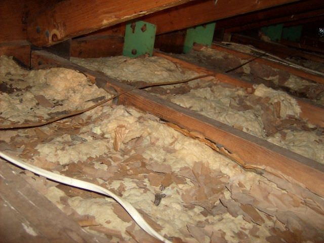

Jim Baird Posted May 17, 2016 Author Report Share Posted May 17, 2016 Thanks for the reply. Here is a gable-end view of the stud tops. They have grooves on the back like flooring. I'll post another of their truss hardware. Maybe is not this brand but maybe a local knockoff. Click to Enlarge 37.88 KB Click to Enlarge 59.15 KB Quote Link to comment Share on other sites More sharing options...

Bill Kibbel Posted May 18, 2016 Report Share Posted May 18, 2016 Click to Enlarge 16.1 KB I think some version of that trim detail in the corner was used in National Homes. Quote Link to comment Share on other sites More sharing options...
