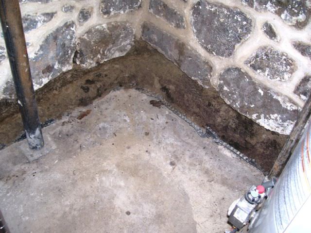

NJinspector Posted August 31, 2016 Report Share Posted August 31, 2016 "In the basement, a perimeter drainage system has been installed around the foundation wall to control water penetration. On a home this age, there is typically no supporting footer under the foundation wall. Installing a perimeter drain can potentially undermine the foundation walls and cause substantial movement / displacement. Have a reputable foundation contractor or structural engineer evaluate and provide repair options to prevent any potential damage. " Katenize me please! thanks in advance Link to comment Share on other sites More sharing options...
Marc Posted August 31, 2016 Report Share Posted August 31, 2016 "In the basement, a perimeter drainage system has been installed around the foundation wall to control water penetration. On a home this age, there is typically no supporting footer under the foundation wall. Installing a perimeter drain can potentially undermine the foundation walls and cause substantial movement / displacement. Have a reputable foundation contractor or structural engineer evaluate and provide repair options to prevent any potential damage. " Katenize me please! thanks in advance Poorly worded. Footer or no footer, perimeter drainage may or may not undermine the foundation depending on how deep it's installed relative to the bottom of the foundation. I'd treat the footer issue separately, depending. I'd offer a suggested write-up but there isn't enough info. Marc Link to comment Share on other sites More sharing options...
Charlie R Posted August 31, 2016 Report Share Posted August 31, 2016 Really? No footer under the foundation wall? If I thought that, then I would write it up to have someone determine if there is a footer or not since it is an assumption there is no footer. Verify first, then repair if needed. Link to comment Share on other sites More sharing options...
kurt Posted August 31, 2016 Report Share Posted August 31, 2016 How old's the house, what's the foundation, and anything else you know for sure. Link to comment Share on other sites More sharing options...
John Kogel Posted August 31, 2016 Report Share Posted August 31, 2016 Too general for such a major issue. If that was in my report, I would question where you got the x-ray vision to see a missing footer. We think the basement drain system you say was installed must be interior and visible, but you do not say so. It may sometimes cause a problem? I need to know if it IS a problem. " A perimeter drain system has been installed in the basement. From the location of the drainage ditch adjacent to the basement wall, I suspect there might not be a footer under the foundation wall." Could the drains be laid on top of the footers? No sign of uneven settlement? Not a problem after all? I'd be choked if you were wrong about that. Link to comment Share on other sites More sharing options...
NJinspector Posted August 31, 2016 Author Report Share Posted August 31, 2016 Kurt, House is from 1830. Field stone foundation. That's why I assume no footer was installed. French drain installed around perimeter, couldn't tell how deep but the floor was removed and patched over about a foot wide. Link to comment Share on other sites More sharing options...
Bill Kibbel Posted August 31, 2016 Report Share Posted August 31, 2016 Jason's got a very valid concern. It's very common in PA & NJ for "waterproofing" contractors to install their perimeter collection systems that suck the earth out from under these footingless foundations. If it's in southern NJ, it's mostly sand that ends up in major foundation failures in months, not years. I have 30 years of expert witness work thanks to these contractors. Most resulted in complete foundation replacement. Link to comment Share on other sites More sharing options...

mjr6550 Posted August 31, 2016 Report Share Posted August 31, 2016 It is a valid concern, but you seem to jump to the conclusion that it is a problem. Depending upon the soil type and depth of the foundation wall, it may not be a problem. I have seen stone foundation walls extend quite a bit below the basement floor slab. Recommending further evaluation is proper in this case. As a structural engineer, I have concerns recommending a foundation contractor. Companies that repair foundations for a living may recommend a solution that is not needed. Personally, I think footing is more professional. Footer is a slang term. For those not familiar with stone foundations, it is common that they do not have a true footing. Recommended practice was to place large stones on the ground as a type of footing. They may or may not have been wider than the width of the foundation walls. Where I have seen the bottom of the foundation walls I don't recall seeing any that were significantly wider at the bottom. Link to comment Share on other sites More sharing options...

Bill Kibbel Posted August 31, 2016 Report Share Posted August 31, 2016 It is a valid concern, but you seem to jump to the conclusion that it is a problem. Depending upon the soil type and depth of the foundation wall, it may not be a problem. I have seen stone foundation walls extend quite a bit below the basement floor slab. I have never, ever seen a stone foundation from that period extend more than an inch or two below a dirt floor or an added concrete floor. Not until quite late in the 19th century do they set the foundations deeper. Link to comment Share on other sites More sharing options...
kurt Posted August 31, 2016 Report Share Posted August 31, 2016 Kurt, House is from 1830. Field stone foundation. That's why I assume no footer was installed. French drain installed around perimeter, couldn't tell how deep but the floor was removed and patched over about a foot wide. Then pretty much what Kibbel said. Usually no footing, maybe a slight spread at the bottom and some rubble...maybe. What you wrote is not bad, kinda boiler platey but not bad given the conditions. Link to comment Share on other sites More sharing options...
Jim Katen Posted September 1, 2016 Report Share Posted September 1, 2016 Basement perimeter drainage systems like this one can sometimes pull soil away from below the foundation walls and cause them to settle, crack, or tilt. Hire an engineer to determine whether or not this is likely to happen with this house. If it is, ask the engineer to design and oversee repairs. Link to comment Share on other sites More sharing options...
mjr6550 Posted September 2, 2016 Report Share Posted September 2, 2016 It is a valid concern, but you seem to jump to the conclusion that it is a problem. Depending upon the soil type and depth of the foundation wall, it may not be a problem. I have seen stone foundation walls extend quite a bit below the basement floor slab. I have never, ever seen a stone foundation from that period extend more than an inch or two below a dirt floor or an added concrete floor. Not until quite late in the 19th century do they set the foundations deeper. I think you are correct about the foundation not extending below the slab in a house of that age, but I still would not jump to that conclusion when writing a report. Link to comment Share on other sites More sharing options...
Marc Posted September 2, 2016 Report Share Posted September 2, 2016 It is a valid concern, but you seem to jump to the conclusion that it is a problem. Depending upon the soil type and depth of the foundation wall, it may not be a problem. I have seen stone foundation walls extend quite a bit below the basement floor slab. I have never, ever seen a stone foundation from that period extend more than an inch or two below a dirt floor or an added concrete floor. Not until quite late in the 19th century do they set the foundations deeper. I think you are correct about the foundation not extending below the slab in a house of that age, but I still would not jump to that conclusion when writing a report. I don't see them jumping to a conclusion, just expressing a concern. Take Jim K's write-up: he left out the 'What is it' and just wrote up the 'What does it mean' and 'What to do about it'. No conclusion. Marc Link to comment Share on other sites More sharing options...
