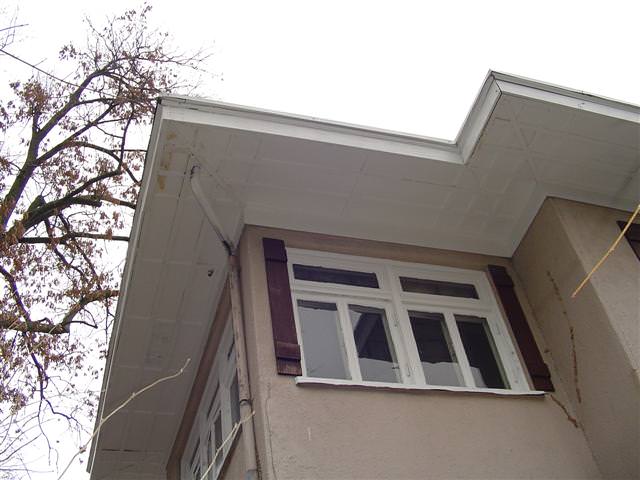

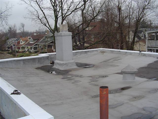

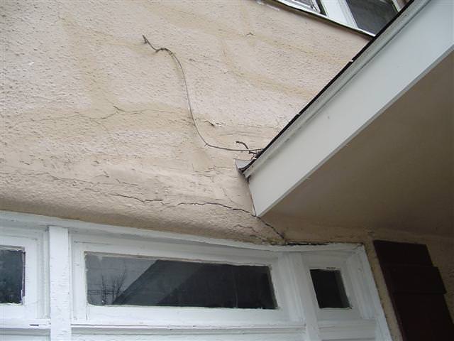

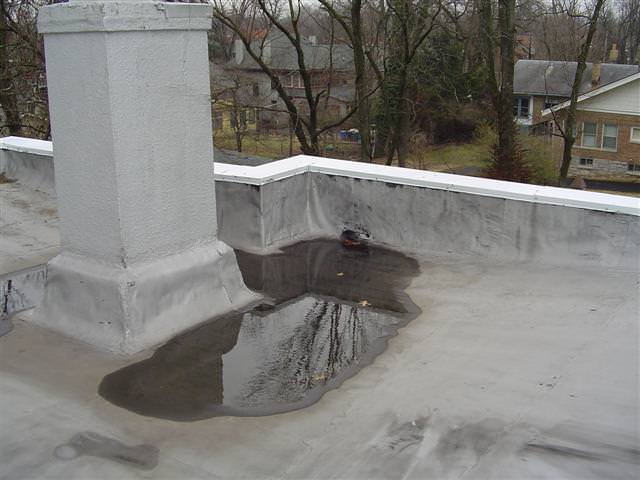

Bain Posted February 23, 2006 Report Share Posted February 23, 2006 A regular client who rehabs POSs for profit had me look at a 110-year-old candidate today. Check out the photos of the concave roof. Water is intended to be directed toward the lone, undersized scupper on the upper, rear portion of the roof, and then trickle off of the lower tier. As you can see, though, none of the surfaces contain proper slopes. Water is seeping through the membrane seams, and also through the outer-periphery metal flashings. The soffits are being destroyed, but worse, water is seeping behind the stucco and eroding it. The dark areas within the second-to-last photo are layers of paint over previous repairs, but they're also wicked damp due to the moisture penetrating the stucco and trickling down the exterior of the house. Has anyone seen this configuration before? And does anyone have a clue how it could be remedied without spending a fortune? Download Attachment: Rooftemp1.jpg 62.32 KB Download Attachment: Rooftemp2.jpg 50.46 KB Download Attachment: Rooftemp3.jpg 46.4 KB Download Attachment: Rooftemp4.jpg 44.9 KB Download Attachment: RoofTemp5.jpg 52.37 KB Quote Link to comment Share on other sites More sharing options...

Bill Kibbel Posted February 23, 2006 Report Share Posted February 23, 2006 At the beginning of my HI career, I inspected several of that style in a neighborhood built in the late 30s. Very unusual for this region. Often had to wear my Wellies to inspect them. I always called them elevated ponds and told them to build a real roof. 20 years later, almost all have shingled hipped roofs. Quote Link to comment Share on other sites More sharing options...
Bain Posted February 23, 2006 Author Report Share Posted February 23, 2006 That was my advice to the buyer, Bill. It was also the best way to address the K and T wiring above the second-floor ceiling. But the cost is prohibitive since she wants to resell the house in a year or so. Quote Link to comment Share on other sites More sharing options...
Steven Hockstein Posted February 23, 2006 Report Share Posted February 23, 2006 I agree it would be best to build a sloped roof over the existing roof. If aesthetics or zoning restricts this option, they can consider a taper insulation roof system with exterior gutters or scuppers (this option will most likely be more costly). Quote Link to comment Share on other sites More sharing options...
jseddy Posted March 2, 2006 Report Share Posted March 2, 2006 Honestly, I'd like to see the roof dm'd and replaced rather than built over. It's hard to tell what lies under that wet skin. Bite the bullet, redo the roof and avoid any problems associated with it in the future. Quote Link to comment Share on other sites More sharing options...
