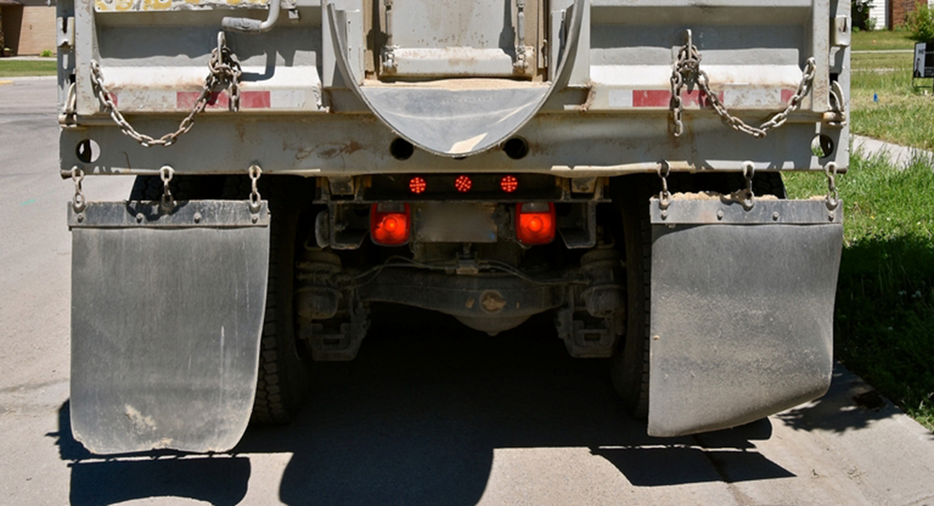

Bill Kibbel Posted March 30, 2020 Report Share Posted March 30, 2020 Plastic slates, aka mud flaps. Curling is very common with the older products. The manufacturers have claimed it's not a defect and is a minor cosmetic issue. A step was added to some installation instructions. The installer should bend each individual slate down at the butt end and corners before installing. I don't think this helped for the long term. Quote Link to comment Share on other sites More sharing options...

Bill Kibbel Posted June 17, 2023 Report Share Posted June 17, 2023 I think the venting guidelines might only be the manufacturer's tool to deflect claims. Here's a better application - plenty of venting. 2 Quote Link to comment Share on other sites More sharing options...
