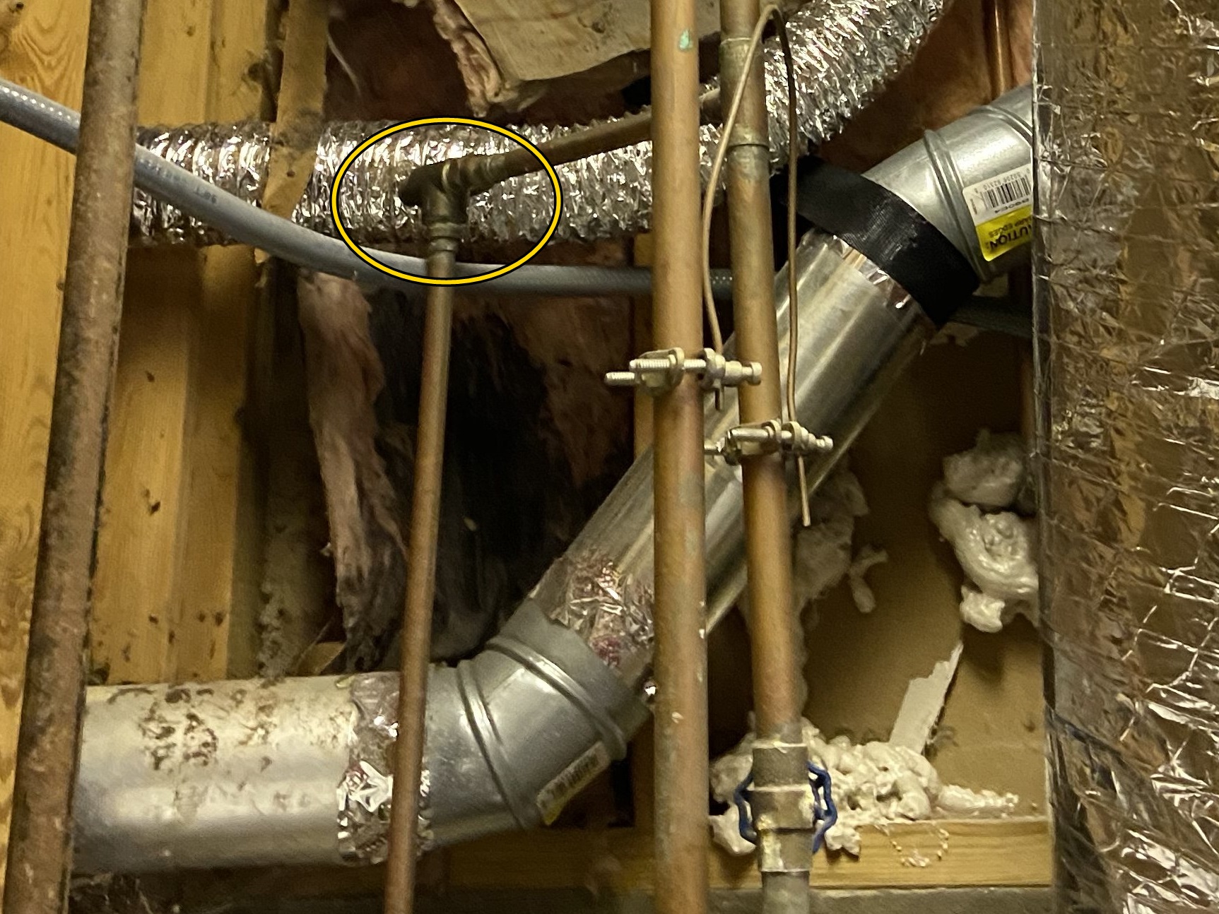

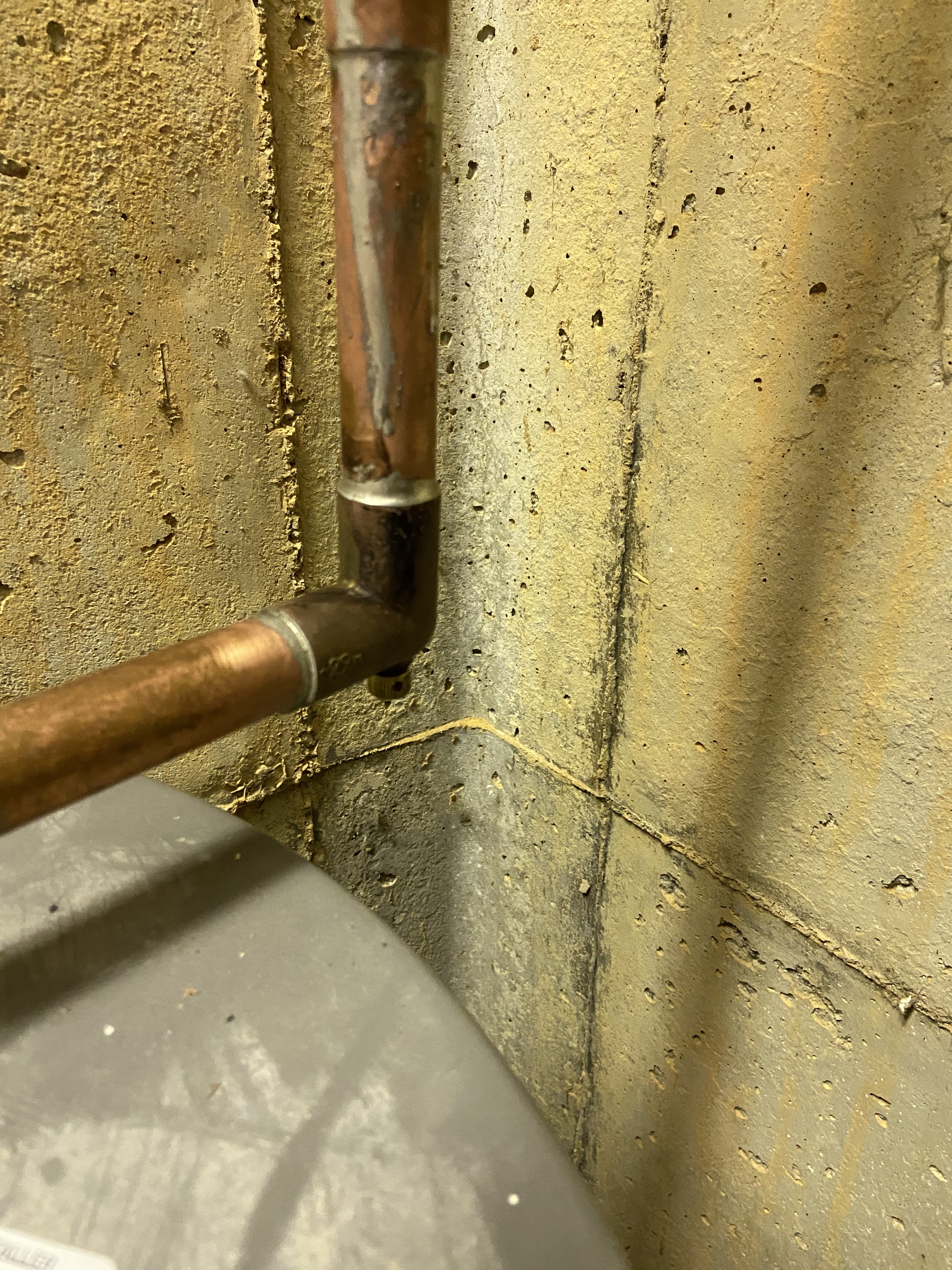

RBP Posted October 26, 2020 Report Share Posted October 26, 2020 Question about a strange TP valve discharge line. So this water heater has a TP discharge line that runs up and out of the house. On initial inspection, the inspector noted the potential for water to collect & corrode the valve as well as the potential for backflow into the water heater. Seller "corrected" the problem by having a plumber come out and install a 90 degree elbow with a drain at the upward turn. Is this legal/good practice? My understanding is the line should drain with gravity which to me means that it should go down & over the side of the WH, but this is at the back of a garage and there is no drain in the room to be able to take the overflow if it opens. What should be the best practice here and is the drain on an elbow really a proper fix for this? Link to comment Share on other sites More sharing options...
Marc Posted October 26, 2020 Report Share Posted October 26, 2020 The T&P drain line should never rise or even level off. It needs to slope downward in the direction of drainage throughout it's length for precisely the reason the inspector mentioned. Link to comment Share on other sites More sharing options...
Tom Raymond Posted October 27, 2020 Report Share Posted October 27, 2020 That is prohibited by every plumbing code except for a Georgia amendment. Are you in Georgia? If you are it's probably allowed. It's still wrong though. Link to comment Share on other sites More sharing options...

Tom Raymond Posted October 27, 2020 Report Share Posted October 27, 2020 The Georgia amendment allowing this is dangerous. It violates every plumbing code (must drain via gravity, cannot be trapped, can't have more than 3 90° elbows), and the valve manufacturer instructions. In the event of a high temp or high pressure failure of the water heater, IF the safety valve functions that mess of plumbing is going to burst...either between the first and second elbow or the bleeder cap is going to become a projectile. And that's a big if. The valve is likely to be corroded from water trapped against it and fail to open, turning the tank into a bomb. That water heater would be safer without a drain extension at all. I was home alone as a teenager when a pressure be vessel exploded. Not an experience I would recommend. Link to comment Share on other sites More sharing options...

Jim Katen Posted October 28, 2020 Report Share Posted October 28, 2020 What's this object? Link to comment Share on other sites More sharing options...
Jim Baird Posted October 28, 2020 Report Share Posted October 28, 2020 1 hour ago, Jim Katen said: What's this object? Thanks, Jim. I did not bird-dog that "termination". That foto actually looks like reduced size as well. Like I said, mr. Fixit was not no plumber! Link to comment Share on other sites More sharing options...
RBP Posted October 28, 2020 Author Report Share Posted October 28, 2020 4 hours ago, Jim Katen said: What's this object? After some time on the phone explaining that this made no sense with the plumber, he returned to the house to look at the whole setup. Said it was some type of pressure relief. Seems like the original installer tried to get around having a thermal expansion tank by putting a T on the T&P line and running it through this thing and back into the cold water line. Had me completely baffled. Georgia code apparently allows the up & out run of the line, but still doesn't allow a T anywhere on it. They ended up cutting this out and running the T&P drain up and out. Plumber echoed Tom's statement that running up & out like this is the most common and expected way these are configured in Georgia. I never saw anything like this while living in the northern part of the country. Link to comment Share on other sites More sharing options...

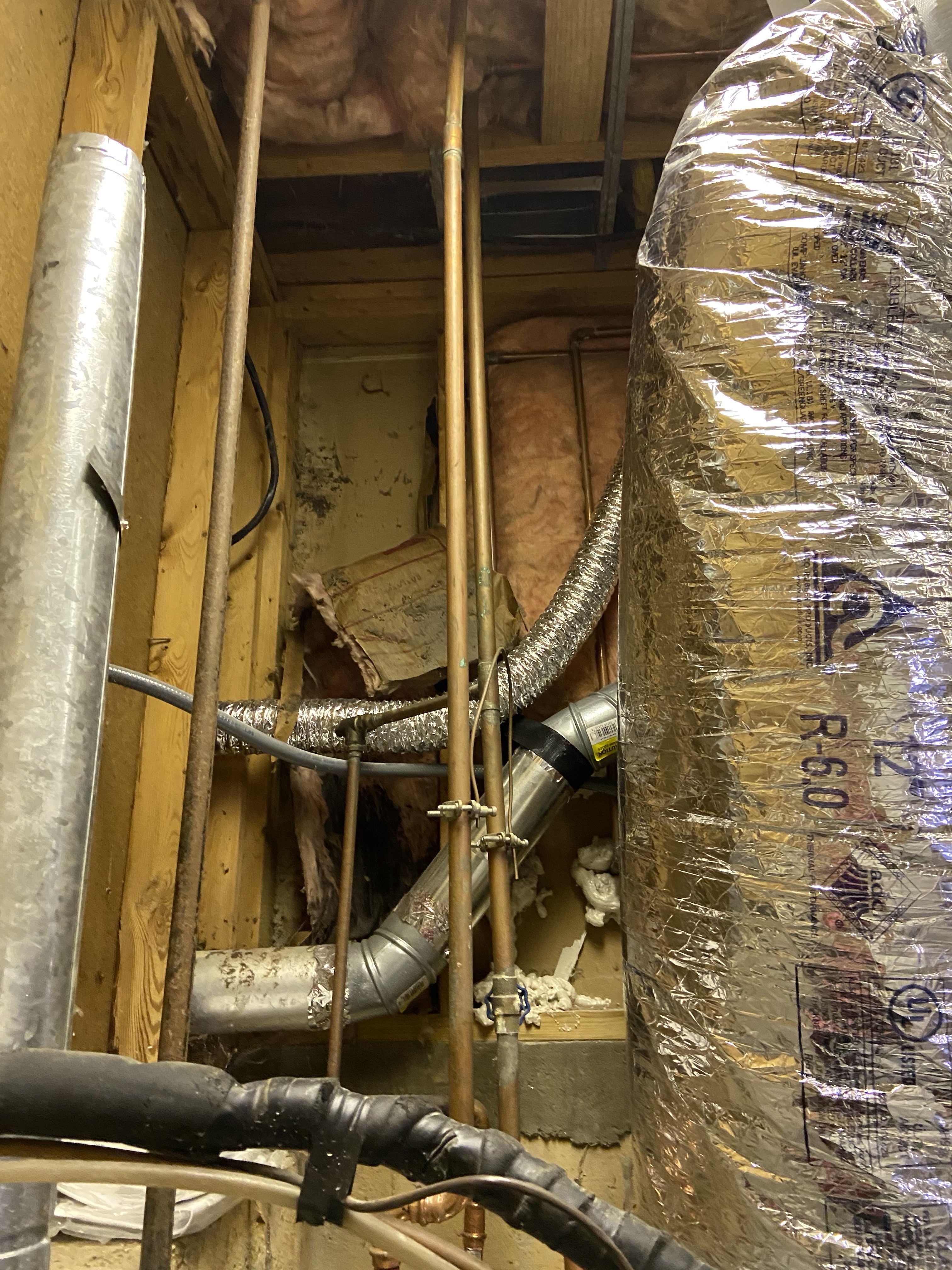

rjbrown2 Posted January 11, 2021 Report Share Posted January 11, 2021 (edited) I believe I live in the same GA county as Jim. This WH was installed in 2007 in one of the corners of my basement. Notice the TPV drain line eventually goes vertical and ultimately has 4 (maybe 5 if there is one on the outside wall), 90 degree bends (one at the top out of sight) <bb Edited January 11, 2021 by rjbrown2 further relevant info on 90 degree bends Link to comment Share on other sites More sharing options...
