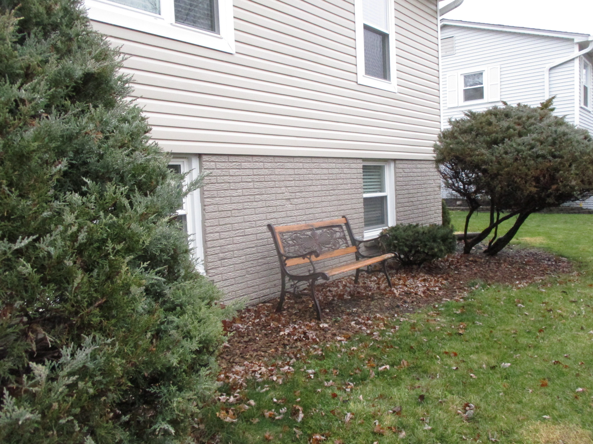

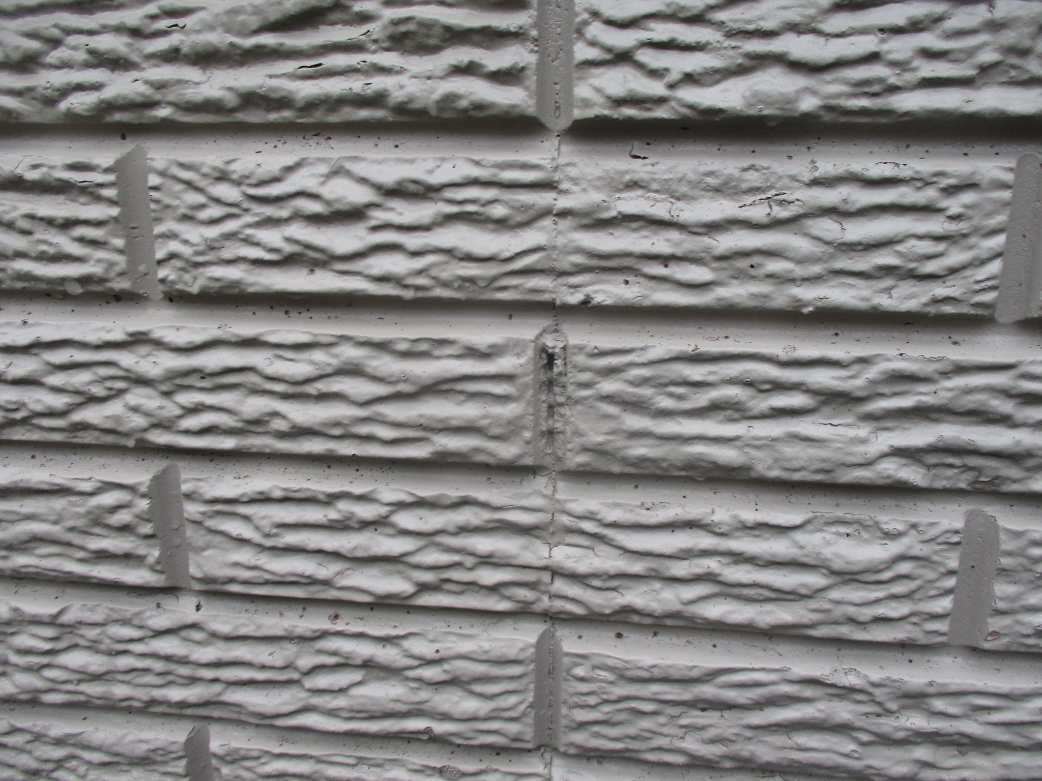

Mike Lamb Posted December 13, 2020 Report Share Posted December 13, 2020 Can anyone identify the siding? Its masonry but it looks like it has been put up in sheets or panels. Early 60s. Quote Link to comment Share on other sites More sharing options...
Jerry Simon Posted December 13, 2020 Report Share Posted December 13, 2020 Looks like stamped concrete. Quote Link to comment Share on other sites More sharing options...
Tom Raymond Posted December 13, 2020 Report Share Posted December 13, 2020 Are you sure it's siding and not cast with patterned forms? Quote Link to comment Share on other sites More sharing options...
Chad Fabry Posted December 14, 2020 Report Share Posted December 14, 2020 That's formed-in-place concrete with decorative forms. Quote Link to comment Share on other sites More sharing options...
Les Posted December 14, 2020 Report Share Posted December 14, 2020 formed in place. not uncommon in parts of mid-michigan. Quote Link to comment Share on other sites More sharing options...
mark parlee Posted December 19, 2020 Report Share Posted December 19, 2020 (edited) Foundation wall, Very common. 8 inches thick sits on a footing. If this were a ranch home or 2 story you would see the top 12 inches or so of this foundation wall Edited December 19, 2020 by mark parlee Quote Link to comment Share on other sites More sharing options...
