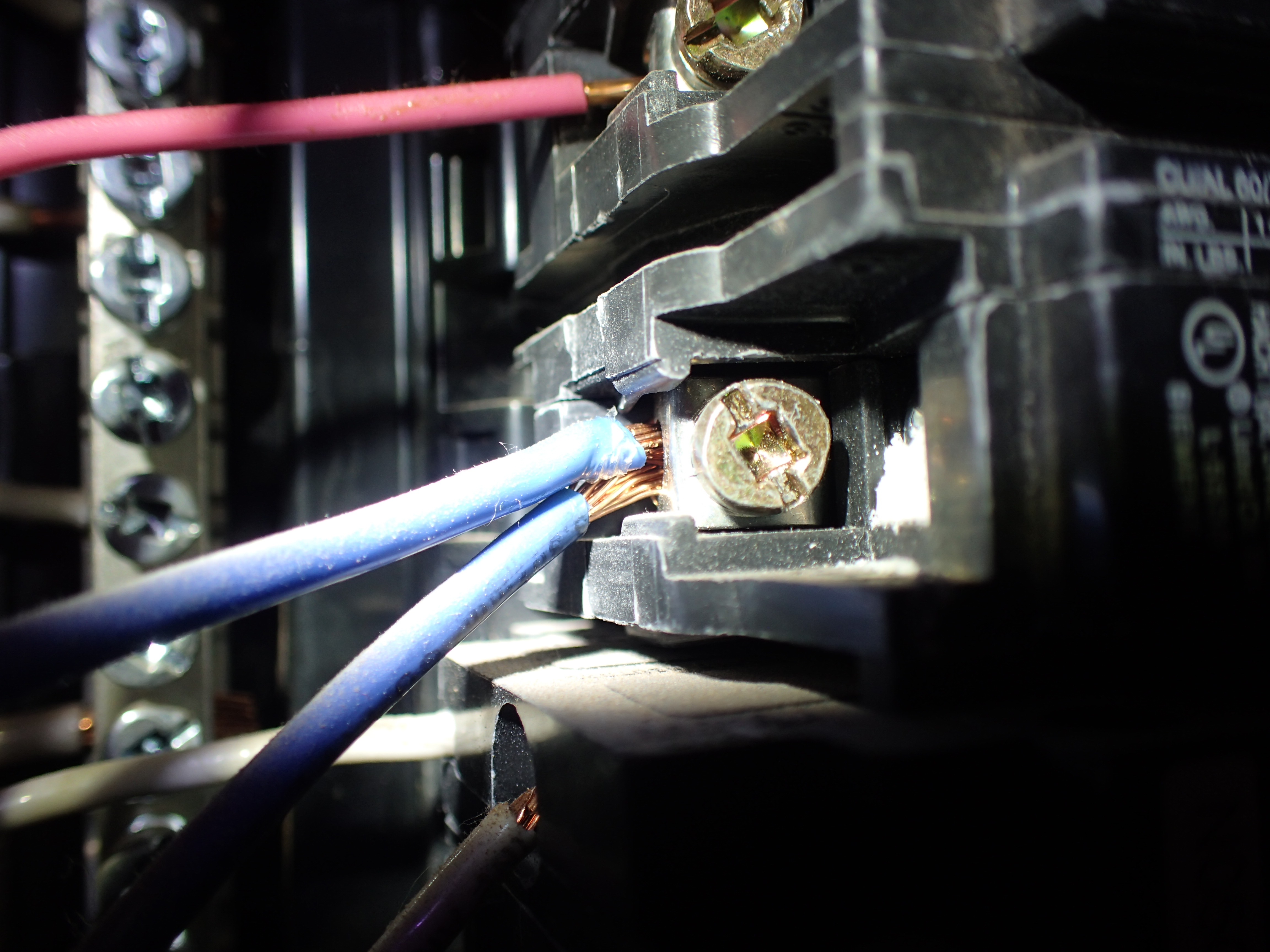

Keith Snell, Blue C, LLC. Posted March 8, 2021 Report Share Posted March 8, 2021 Hello All New to this forum, Been doing inspections in the Caribbean for 18 years. With new techs, I realize I need to reach out, so this is my first question... I run into this constantly. Single double tapped 20 amp breaker because the panel is slightly over capacity. Personally, I dont think it is a safety or fire hazard, but it is a code violation. Wondering how you guys write this up. Keith Blue C Home Inspections Link to comment Share on other sites More sharing options...
CNewhouse Posted March 8, 2021 Report Share Posted March 8, 2021 Only Square D and Cutler-Hammer make breakers that are listed to accept 2 conductors. If I see a breaker that is double tapped and should not be, I point it out and suggest the buyer have the issue corrected. It's very simple to to install a wire nut and pigtail and eliminate the double tap. Is it a fire hazard? I can't say. But I can say that it's wrong and there's potential for loose connections and overheating. My opinion is it should be pointed out every time. Immediate concern or not, it's wrong (usually). Link to comment Share on other sites More sharing options...
Marc Posted March 9, 2021 Report Share Posted March 9, 2021 I seldom write it on account of always finding other issues much more worthwhile of my client's time. I look for the Marlins, not the Minnows. Link to comment Share on other sites More sharing options...
Mike Lamb Posted March 10, 2021 Report Share Posted March 10, 2021 I always write it up and call for electrician to correct it. Today's double tap showed insulation that might be melting. I also write up under wired breakers, 14 AWG with 20 amp, although I've never seen a problem with this. Link to comment Share on other sites More sharing options...
Erby Posted March 14, 2021 Report Share Posted March 14, 2021 If it's wrong, make sure it's in your report. Let the client and the electrician decide if it's important to them. Minnows tend to become important down the road. Link to comment Share on other sites More sharing options...
hausdok Posted March 18, 2021 Report Share Posted March 18, 2021 As the first respondent said, it's easily corrected with a pigtail and a wire nut. It will take longer to get the cover off than to make the correction. Link to comment Share on other sites More sharing options...
