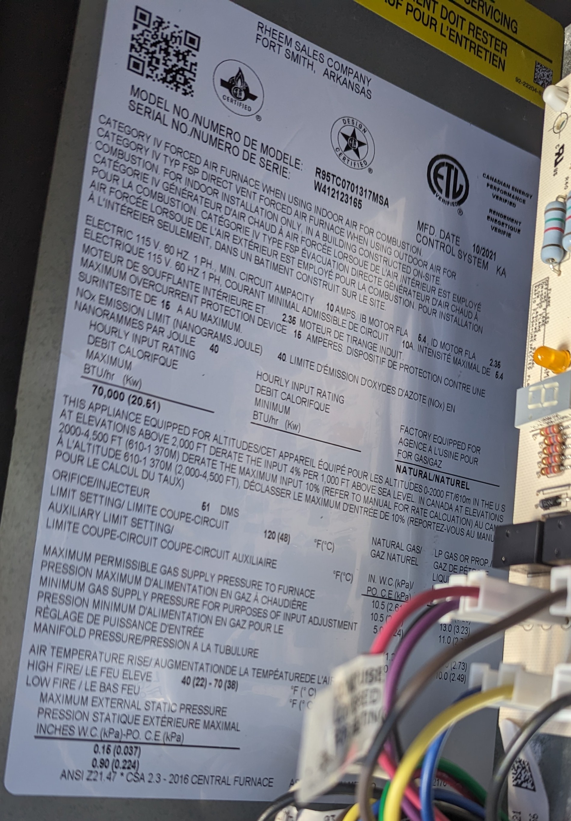

Jim Katen Posted January 22, 2023 Report Share Posted January 22, 2023 That's a great question. I didn't even look at the capacity of the generator. Most furnaces are going to need 8-10 amps, not the 7.5 that this one produces. It's possible that the generator just isn't producing enough power. Quote Link to comment Share on other sites More sharing options...
Marc Posted January 23, 2023 Report Share Posted January 23, 2023 Makes sense. That generator is rated 7.5 amps steady-state. The blower on my 3 ton Rheem is 8.6 amps FLA. Quote Link to comment Share on other sites More sharing options...

Jim Katen Posted January 26, 2023 Report Share Posted January 26, 2023 Look at the furnace's rating plate - it's almost certainly going to be greater than 7.5 amps. Then just try bonding the grounding terminal to the neutral at the generator - even temporarily as a troubleshooting measure. Quote Link to comment Share on other sites More sharing options...
Denray Posted January 26, 2023 Author Report Share Posted January 26, 2023 "Then just try bonding the grounding terminal to the neutral at the generator - even temporarily as a troubleshooting measure". So, we did that and the fan turned on, but then there was this click click noise? And then the burners lit up. And a little later there was warm air coming out our vents. Color us happy! Thanks again for your help on this. Pulled off the panel holding the outlets on the generator and right on the back side there was a hole to push the jumper in and a screw right next to it to complete the bonding. Piece of cake. Quote Link to comment Share on other sites More sharing options...
Jim Katen Posted January 28, 2023 Report Share Posted January 28, 2023 I see that the minimum circuit ampacity is 10 amps . . . though if it's working, I guess that's all you need. Quote Link to comment Share on other sites More sharing options...
