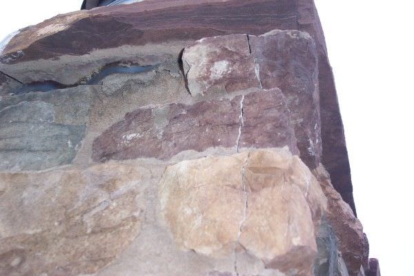

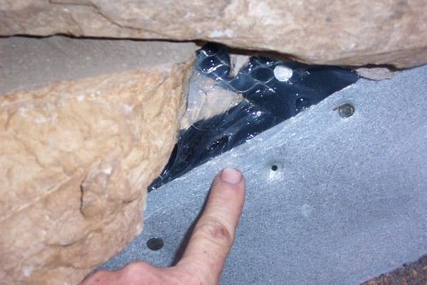

tneumann Posted May 6, 2006 Report Share Posted May 6, 2006 I was hired to do a re-inspection of 5 items at a home that was inspected by another company....simple right? Only 5 items.... One of the items was loose grout/mortar at top of a stone chimney and missing at flashing.... Instead of using mortar they used clear silicone/caulking. Looks like 100% silicone....seller mentioned the "mason" told here he couldn't get new mortar to stick to old mortar. I also found a giant crack that isn't mentioned in the items I am supposed to check on. Report the crack or not to report the crack... Silicone ok or not ok? Thanks in advance. Download Attachment: 1043luckylady 013.jpg 63.08 KB Download Attachment: 1043luckylady 002.jpg 69.89 KB Quote Link to comment Share on other sites More sharing options...
hausdok Posted May 6, 2006 Report Share Posted May 6, 2006 Hi, That looks like wire lath behind the "stone" so it's faux stone. A crack through that stuff is just cosmetic. The flashings should extend up behind that veneer onto the face of the underlying sheathing. Sealing the slot along the top of the flashings in that case doesn't make any sense because the veneer has to drain. ONE TEAM - ONE FIGHT!!! Mike Quote Link to comment Share on other sites More sharing options...

Jim Katen Posted May 6, 2006 Report Share Posted May 6, 2006 Originally posted by tneumann I was hired to do a re-inspection of 5 items at a home that was inspected by another company....simple right? Only 5 items.... No. It's a mine field. One of the items was loose grout/mortar at top of a stone chimney and missing at flashing.... Instead of using mortar they used clear silicone/caulking. Looks like 100% silicone....seller mentioned the "mason" told here he couldn't get new mortar to stick to old mortar. Well, he's *really* going to have a hard time getting it to stick now, eh? As Mike said, the missing mortar isn't the issue. That flashing should have gone behind the paper, not on top of it. I also found a giant crack that isn't mentioned in the items I am supposed to check on. Report the crack or not to report the crack... Silicone ok or not ok? Thanks in advance. The crack is of minor concern, but you should probably mention it. Explain that it's only of cosmetic importance and recommend that they patch it with color-matched mortar if it bothers them to look at it. The silicone is not ok. I think you should diplomatically explain that the flashing is incorrectly installed and should be re-installed properly to lessen the chance of leaks around the chimney chase. How did you come to be reinspecting the work of another inspector? - Jim Katen, Oregon Quote Link to comment Share on other sites More sharing options...
Brian G Posted May 6, 2006 Report Share Posted May 6, 2006 Originally posted by tneumann Instead of using mortar they used clear silicone/caulking. Looks like 100% silicone....seller mentioned the "mason" told here he couldn't get new mortar to stick to old mortar. Apparently the "mason" has never heard of repointing. Jeez. Is it right? Almost certainly not. Will it work? Maybe. I don't know of anyone trying to use silicone for that purpose or what result they got. The manufacturers usually list the materials it will and won't stick to well on the tube. If it's 100% silicone it'll probably take the heat okay, but other than that we're looking at an experiment. Brian G. Mason With Pointy Head Noted at Chimney [:-dunce] Quote Link to comment Share on other sites More sharing options...
mgbinspect Posted May 6, 2006 Report Share Posted May 6, 2006 Well, for what it's worth, I'm totally unfamiliar with this material and installation process. I've never worked with paste-it stone. But, if masonry surfaces are adequately cleaned and moistened (roughed up if necessary) and the new work properly cured (which is the critical key) there is a high probability that the materials will indeed successfully bond. On occasions where I thought it necessary, I've made and applied a cement paste about the consistency of paint to the old surface immediately before applying the new work. But again, days of curing is paramount. Quote Link to comment Share on other sites More sharing options...
tneumann Posted May 6, 2006 Author Report Share Posted May 6, 2006 I was hired by a realtor who couldn't get the other inspector to come up for less than the total inspection fee....this area is out in the boonies. I didn't think the silicone was proper either...does it repel the water and do what it is intended...? (keep the water out) Probably it does...I also thought the flashing was incorrect....I also thought repointing would be ideal...not caulking like the dickens.... Question I have is: Since I was only hired to check the items listed...and my agreement w/ my client specifically says that all other items are not part of the inspection...should I mention the crack at all or if I mention the crack and subsequently get sued for not finding something else entirely will the lawyers pick me apart by saying since I went above and beyond on one thing, I should have gone above and beyond on others? Sigh....I wish I could learn to say no...never been very good at saying no except to my kids. Quote Link to comment Share on other sites More sharing options...

mgbinspect Posted May 6, 2006 Report Share Posted May 6, 2006 Consider addressing the specific areas requested in your report and be very clear about what you were asked to do. I regret that the two photos don't offer me enough to guide you regarding the mason's decision, but in most cases, a proper masonry repair is entirely possible. If you have other concerns, mention them as a post script in a cover letter. "Please be advised that in the course of providing the attached report the following condition was observed: Etc." That's probably the most sensible way to mention a concern regarding an area you were not asked to inspect. Just my two cents. Good luck. Quote Link to comment Share on other sites More sharing options...

Jim Katen Posted May 7, 2006 Report Share Posted May 7, 2006 Originally posted by tneumann I was hired by a realtor who couldn't get the other inspector to come up for less than the total inspection fee....this area is out in the boonies. I don't blame him. However, the realtor and/or the buyer should have understood that inspector's terms when they hired him. You're now being put in a very awkward position. I didn't think the silicone was proper either...does it repel the water and do what it is intended...? (keep the water out) Probably it does Yes, it repels water. No, it's not "intended" to serve as a replacement for mortar or faux stone. It's a dumb idea. It doesn't belong on this chimney chase. It's the work of a dumbass. ...I also thought the flashing was incorrect....I also thought repointing would be ideal...not caulking like the dickens.... Re-pointing or tuckpointing is something you do to masonry. This isn't masonry. It's lick-n-stick fake stone. To fix the stone part, you'd have to tack up a small piece of that metal lath, butter it up with a modified mortar product and stick on a triangular piece of that faux stone. You might have to secure the stone in place with stone wire or even duct tape till it sets up. HOWEVER, that shouldn't be done here till the flashing is fixed first. The big issue here is the flashing, not the stone. Question I have is: Since I was only hired to check the items listed...and my agreement w/ my client specifically says that all other items are not part of the inspection...should I mention the crack at all or if I mention the crack and subsequently get sued for not finding something else entirely will the lawyers pick me apart by saying since I went above and beyond on one thing, I should have gone above and beyond on others? NO, NO, NO. You don't get sued for finding problems. I wish that particular bit of home inspector folklore would wilt and die soon. You get sued for missing stuff, not for finding stuff. Sigh....I wish I could learn to say no...never been very good at saying no except to my kids. Too late now. Write a report telling you client that the flashing is incorrect and needs to be re-installed -- probably all the way around the chimney chase. Then tell them to get a different contractor to fix the lick-n-stick properly, per the manufacturer's printed installation instructions, without using silicone. Just tell the truth and be a friend to the person who's hiring you. - Jim Katen, Oregon Quote Link to comment Share on other sites More sharing options...
Brian G Posted May 7, 2006 Report Share Posted May 7, 2006 Originally posted by Jim Katen Re-pointing or tuckpointing is something you do to masonry. This isn't masonry. It's lick-n-stick fake stone. True. I stand corrected on that point. Just tell the truth and be a friend to the person who's hiring you. Good advice and undoubtedly the best course in general. You can still get in a mess, but the other kinds of mess are worse. Maybe I've been lucky so far, but I have yet to get a bad reaction from a client from being totally straight with them. Sellers and agents are a different story. Brian G. We're On a Need to "No" Basis Sometimes [:-mischie Quote Link to comment Share on other sites More sharing options...

tneumann Posted May 8, 2006 Author Report Share Posted May 8, 2006 UPDATE My clients' realtor is a bit upset but understanding..he is having the original inspector come out and look at it also, preliminary thoughts are that i am correct in calling out the silicone..thanks guys for the tips. Sellers agent is not happy and wants to know why the original guy wasn't called out to begin with....apparently the sellers agent knows this guy from USInspect! LOL... Anyway, so far so good....thanks again for all the helpful advice. Quote Link to comment Share on other sites More sharing options...

Jim Katen Posted May 9, 2006 Report Share Posted May 9, 2006 Originally posted by hausdok Good job, Although, the fact that the guy is with USInspect really has nothing to do with it. It could have been anyone from any number of companies making the same mistake. . . Of course, we don't really know if he even made a mistake. The top of the flashing might have been covered by a flake of mortar when he was there. Maybe the repair guy knocked it out of the way to make room for his silicone. - Jim Katen, Oregon Quote Link to comment Share on other sites More sharing options...
