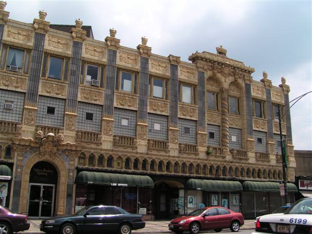

kurt Posted May 10, 2006 Author Report Share Posted May 10, 2006 If you're into masonry, this is a masonry city. I look @ masonry all day, every day. Some of the stuff is just plain unreal. How about this one of the decorative terra cotta? Download Attachment: terra cotta.JPG 58.29 KB Quote Link to comment Share on other sites More sharing options...
mgbinspect Posted May 10, 2006 Report Share Posted May 10, 2006 There are some unbelievable masonry building here in Richmond and in Washington, DC. Actually, if you've ever been to the Pro-ASHI seminars there is some incredibly intricate and ornate multi-story buildings in Pittsburgh, PA. I saw one there that had a cornice that corbeled out probably three feet into arches about five or six feet tall. Truly amazing stuff. It kinda made you jittery walking the sidewalk under it. At any rate, I've been flying around on weekends seeing America for about three years and Chicago's on the list... (Travelocity.com last minute deals. Flight room and car for unbelievable prices. You just have to be ready to GO... Went to Atlanta for two night room, flight and car $306.00 In fact, I went to Inspection world and NAHI's convention back to back 5 nights in a hotel, car and round trip flight... $600.00 Ya can't beat it!) Quote Link to comment Share on other sites More sharing options...
