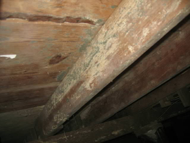

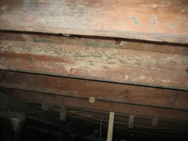

rlskfoster Posted June 27, 2006 Report Share Posted June 27, 2006 Does any body recognize this white and green stuff. It was all over the joists and girders in todays inspection. It would wipe away like dust. Buster Download Attachment: Stevenson 046.jpg 42.55 KB Download Attachment: Stevenson 045.jpg 44.34 KB Quote Link to comment Share on other sites More sharing options...
mgbinspect Posted June 27, 2006 Report Share Posted June 27, 2006 I see that stuff now and then too here in Richmond. It's definitely some form of fungi. It doesn't usually coincide with structural damage, and is typically seen in old houses with no vapor barrier here. I call for any fungal growth on floor framing to be treated. It's kinda funny how framing on old homes almost seems to become petrified and impervious to decay. Quote Link to comment Share on other sites More sharing options...
rlskfoster Posted June 27, 2006 Author Report Share Posted June 27, 2006 Thats probably it. The wood is solid and did not seem to be decaying. No vapor barrier. We seldom have a vapor barrier in these parts. Dryer vented into crawl and I'm sure that did not help. Thanks, Buster. Quote Link to comment Share on other sites More sharing options...

mgbinspect Posted June 27, 2006 Report Share Posted June 27, 2006 Hmmmm... When I went to a Pro-ASHI Seminar a while back one of the speakers was an attorney that specialized on mold cases. He pretty much encouraged us to: 1. State that we observed was an unidentified form of fungal growth assuring us that it's ALL fungi of one form or another. 2. Refer it to an "Industrial Hygenist". (There is actually an engineering firm here in town that does testing and makes recommendations.) 3. Lean toward it's potential to be a threat to structure and not over-emphasize the health implications. 4. And leave it at that. That's 2 - 3 year old info, but that's what I do. It's pretty rare that I see fungal growth that requires that kind of action. Most of the time it's the normal low grade run of the mill crawlspace crap that pest companies have sprays for. It's got to be pretty bad for me to refer out. Quote Link to comment Share on other sites More sharing options...
