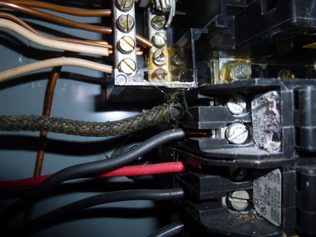

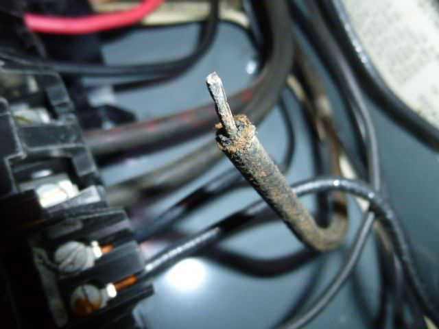

JDP Posted April 28, 2013 Report Share Posted April 28, 2013 Originally posted by Jim Katen Quote:Originally posted by dtontarski I think it is some type of coated copper and not AL. I'm looking for more information on coated copper...coated with what...what is the precise name for it...is it a copper alloy? id="quoteN">As Mike said, it's called tin-coated copper. Before thermoplastic insulation, electrical wires were insulated with rubber. The manufacturers added sulfur to the rubber to help it cure. Since sulfur is corrosive to copper, they had to protect the copper by coating it in tin. With the advent of thermoplastic insulation, there was no longer any need to coat the copper. Quote:I'm guessing that AL is probably plastic coated as Romex came into use in the mid-60's when the copper shortage came about. id="quoteN">All of the aluminum wire I've ever seen is insulated with plastic. Some may have existed much earlier, but I doubt that it was used in houses. Perhaps aircraft? BTW, Romex isn't synonymous with thermoplastic. The General Cable Company invented it in Rome, NY in the early '20s. It was made with cotton cloth & varnish. - Jim Katen, Oregon I would love some help identifying this wiring, older home built in 1935, obviously some upgraded. Saw these wires started thinking aluminum, but some is obviously stranded, some I think is stranded but the ends are just compressed, cloth jacket, used on 120 Volt circuit supplying outlets and lights. Click to Enlarge 38.72 KB Click to Enlarge 51.89 KB Click to Enlarge 26.18 KB Click to Enlarge 37.09 KB Quote Link to comment Share on other sites More sharing options...
John Kogel Posted April 29, 2013 Report Share Posted April 29, 2013 All of the aluminum wire I've ever seen is insulated with plastic. - Jim Katen, Oregon I find Al here that has a plastic insulation but a cloth jacket, the early version. I would love some help identifying this wiring, older home built in 1935, obviously some upgraded. Saw these wires started thinking aluminum, but some is obviously stranded, some I think is stranded but the ends are just compressed, cloth jacket, used on 120 Volt circuit supplying outlets and lights. That is Tinned Copper. If you cut an end, you will see a copper core. Pic 2, you have a neutral with two ground conductors all sharing the same screw. Bare ground wires can be doubled or tripled, but the neutral conductors should not be doubled with another wire, for safety. Quote Link to comment Share on other sites More sharing options...
