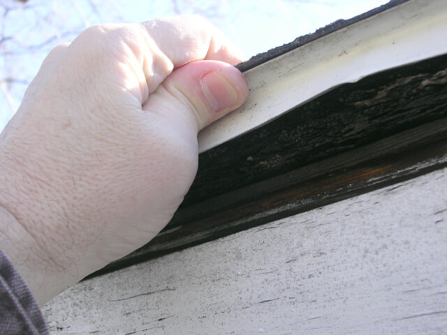

ozofprev Posted April 26, 2007 Report Share Posted April 26, 2007 Without seeing all of the evidence, I agree it's hard to know for sure. I have a seller now who is pissed at me because I told the buyer that there are three layers of shingles on the roof. The seller said that's a lie. He points to the roof and says, "Look, one layer, can't you see?" He had installed a new drip edge to cover up the two bottom layers, so it looked like one layer. Download Attachment: shingle.jpg 139.94 KB Link to comment Share on other sites More sharing options...
