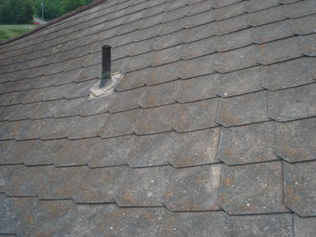

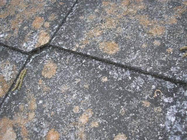

This roof is on a 1913 farmhouse. Are these shingles properly called transite shingles? Ambler shingles? While there is a lot of moss on this roof, it shows no signs of leakage with the exception of the chimney flashings. I was concerned with the shingles breaking, so I did not walk the roof (and I really wanted to look at those flashings). Anyone have experience walking these roofs? While I know that a test is the only way to tell for certain if there is asbestos present, the client is aware that there very likely IS asbestos, and plans to replace the cover.

They could be manufactured by the Ambler Asbestos Shingle & Sheathing Company (Est. 1905), but I've never heard them referred to as "Ambler shingles". Calling them Transite shingles would be appropriate, but I like to use the name that clearly defines what they are: cement asbestos shingles.
I walk a lot of roofs, but not these - and I'm a nimble little guy.
Some background: http://www.oldhouseweb.com/stories/Detailed/15063.shtml

Thanks Bill,
Cement asbestos shingles it is. After reading your article I am relieved that I followed my instincts as to the brittleness of these shingles (and the danger of walking on them). I'm fairly nimble, but at 6'4" 215, I'm not so little.

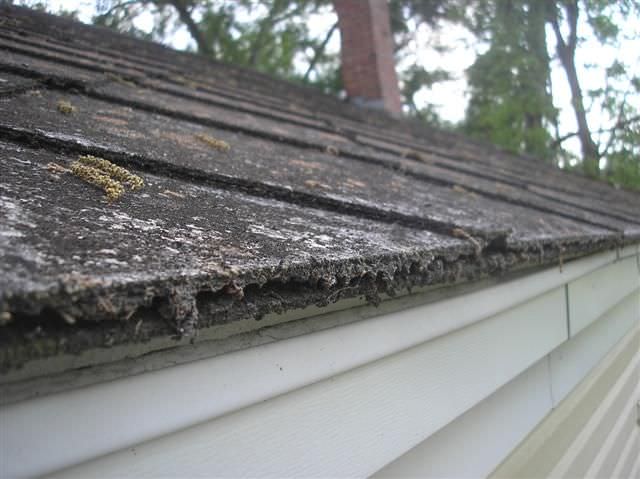

The clients thinking on replacement has more to do with cosmetics than function or asbestos concerns. While there is a bunch of moss (common with this material as it ages, I have come to understand), the shingle are keeping water out of the structure. I would guesstimate that this cover has been in place better than 40 yrs. Just out of curiosity, does anyone know of a good way to get rid of the moss on a cover of this type without damaging the shingles?

While the cement asbestos tile roof on the main house is old and needs a few tiles repaired I don't recommend replacing it. A roofing contractor, familiar with working with cement asbestos shingles, should be able to repair it and make it last a good long time.
Whoever conducts the necessary repairs needs to be familiar with these shingles as they can be easily damaged if the repair person doesn't know exactly how to work with these shingles.
For more information on cement asbestos tile roofs read this article from The Old House Journal website: http://www.oldhouseweb.com/stories/Detailed/15063.shtml
Also see the comments in section 2.1 regarding old, historic properties and section 2.3 regarding asbestos.
