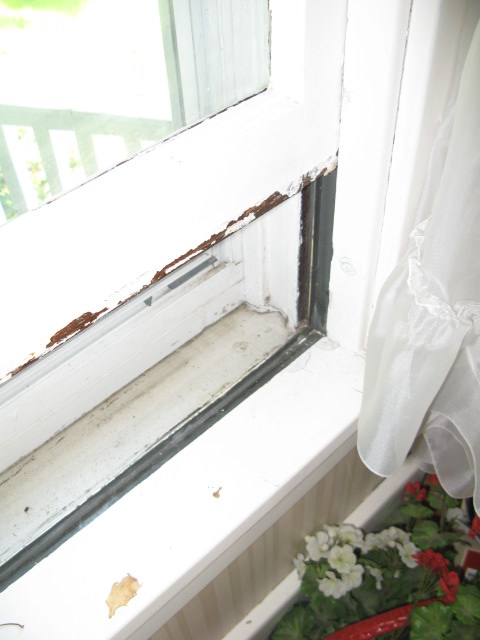

dtontarski Posted July 22, 2007 Report Share Posted July 22, 2007 Can anyone provide me a link to a good website, document or recommendation for a book that will help be better understand how to date window construction, based on type of jamb liners, balance systems, etc.? I've attached a photo - sorry that it's a bit washed out...so much for having an undergraduate degree in photography. The jamb is metal lined, the home was built in 1910. I'd rather say the windows "are" original than "appear" to be original in my report. Any direction and guidance would be greatly appreciated. Thanks. Dave Tontarski The Finger Lakes Region of NYS Image Insert: 72.75 KB Quote Link to comment Share on other sites More sharing options...
Les Posted July 22, 2007 Report Share Posted July 22, 2007 Hey Dave, Don't have any authority, but they sure look like typical zinc sash strips. Also the blind stop looks from that era. Old House Journal had a piece on windows in the late 90's. Maybe Walter will recall. I'd be looking there and asking Bill. Quote Link to comment Share on other sites More sharing options...
Neal Lewis Posted July 22, 2007 Report Share Posted July 22, 2007 Around here the zinc strips are uncommon for 1910. I would also be looking at the interior/exterior casing, stool and other parts to make a determination. Anything wrong with saying they are "most likely" original? Quote Link to comment Share on other sites More sharing options...
inspector57 Posted July 22, 2007 Report Share Posted July 22, 2007 I'd rather say the windows "are" original than "appear" to be original in my report I would personally leave room for some doubt in my wording. I would not want someone to try to hang their valuation of a historic property on my 5 minute evaluation of their windows. Their are experts that can be hired to determine the historical accuracy of building details. I think this is going beyond the SOP and might come back to haunt you. I too try to eliminate the "appears to be" inspector speak from my reports but this may be one area you might want to leave it rather than pay for it later. Maybe say" the windows are similar to original windows..." or something along those lines. Jim Quote Link to comment Share on other sites More sharing options...

SonOfSwamp Posted July 23, 2007 Report Share Posted July 23, 2007 Originally posted by Les Hey Dave, Don't have any authority, but they sure look like typical zinc sash strips. Also the blind stop looks from that era. Old House Journal had a piece on windows in the late 90's. Maybe Walter will recall. I'd be looking there and asking Bill. Here in Nashville, the metal weatherstripping screams 1950s. There might be some useful info in the OHJ archives, but... an experienced HI, after say a year of steady work, ought to be able to eyeball windows and know their vintage. Same as HIs ought to be able to look at avocado-green refrigerators and know their vintage. Any HI, even a newbie, ought to be able to ride down a street and know instantly when the houses were built. It's really not hard to learn design vocabulary. WJ Quote Link to comment Share on other sites More sharing options...
Bill Kibbel Posted July 24, 2007 Report Share Posted July 24, 2007 My knowledge of house part chronology of post 1900 buildings is rather limited. That being disclosed, I would expect to see a cord/weight/pulley system or a tape spring balance system in the window jambs of a 1910 home. The jamb liners could've been retrofitted later - like when the cotton ropes broke. Sash construction and glass manufacture method would be a better guide to the vintage of the windows. Quote Link to comment Share on other sites More sharing options...
Les Posted July 24, 2007 Report Share Posted July 24, 2007 Bill, If it was float glass, it would be 1910? I thought the tape system was circa 1920. Quote Link to comment Share on other sites More sharing options...
Bill Kibbel Posted July 24, 2007 Report Share Posted July 24, 2007 Originally posted by Les Bill, If it was float glass, it would be 1910? I thought the tape system was circa 1920. Float glass was not produced in the US until after 1960. Pullman was manufacturing the original tape spring balance in 1886 (& still do). Quote Link to comment Share on other sites More sharing options...
