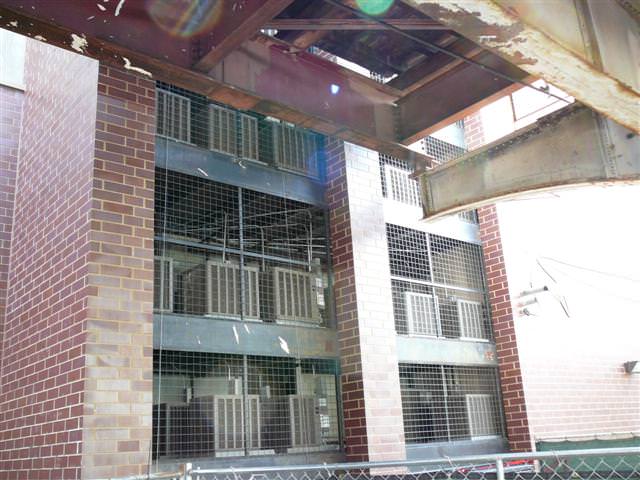

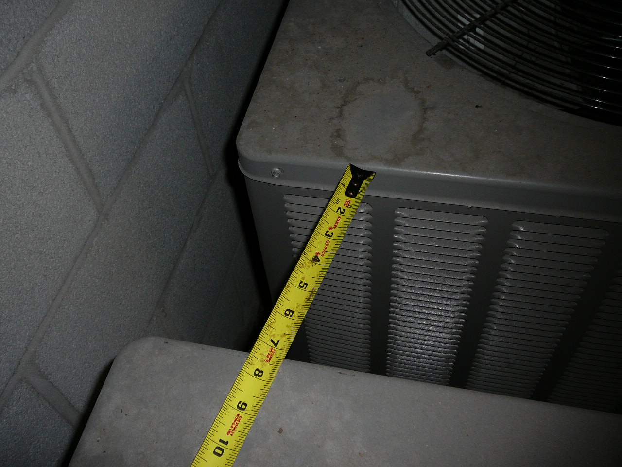

kurt Posted August 28, 2007 Report Share Posted August 28, 2007 Been googling for a while, but maybe I'm dense.... I'm looking for simple installation requirements delineating distances between AC compressors and adjacent objects/walls/landscaping. I'm looking @ a building that has 38 compressors crammed into a masonry "box" that's 22'x22'x7' (approx. 3400cf). I know it's wrong, I just need some numbers. Any help? Quote Link to comment Share on other sites More sharing options...
homnspector Posted August 28, 2007 Report Share Posted August 28, 2007 For A/C compressors it is usually 12 inches so I would think 2 feet between units. However, it may be different for air compressors.[] Quote Link to comment Share on other sites More sharing options...
homnspector Posted August 28, 2007 Report Share Posted August 28, 2007 Fron RUUD: DIMENSIONS AND INSTALLATION CLEARANCES UNIT MODEL NUMBER EXPLANATION ââ¬â 036 J A S S - RECIPROCATING COMPRESSOR Z - SCROLL COMPRESSOR AB (VARIATION) C C - 208/230-3-60 (POWER SUPPLY) D - 460-3-60 J - 208/230-1-60 Y - 575-3-60 BTUH x 1000 (NOMINAL CAPACITY) MODEL SERIES AIR DISCHARGE ALLOW 60" [1524 mm] CLEARANCE AIR INLETS (LOUVERS) ALLOW 12" [305 mm] MIN. CLEARANCE 3 SIDES 24" [610 mm] ACCESS Quote Link to comment Share on other sites More sharing options...

kurt Posted August 29, 2007 Author Report Share Posted August 29, 2007 And, it was under the El tracks; every 5 minutes a train thunders by. It was 130degF the day I was in there looking @ the AC. Image Insert: 73.32 KB Image Insert: 350.05 KB Quote Link to comment Share on other sites More sharing options...
Terence McCann Posted August 29, 2007 Report Share Posted August 29, 2007 What was the application for Kurt? Apartment/condo complex? I would have liked to put a set of gauges on a few of those to see how high the head pressure was. That has got to be hot as hell in that space. Quote Link to comment Share on other sites More sharing options...
kurt Posted August 29, 2007 Author Report Share Posted August 29, 2007 Originally posted by Terence McCann What was the application for Kurt? Apartment/condo complex? I would have liked to put a set of gauges on a few of those to see how high the head pressure was. That has go to be hot as hell in that space. 41 unit condo building. I'm working w/the HOA to figure out weird stuff w/the building, and this is one of the items. It was hot; very hot. The developer had set up a cheap box fan in the access door to get some air into the AC area; I shut it off momentarily to see what would happen and the AC area temp spiked up to about 140degF. The discharge from one level of AC was run up and was sucked in by the intake of the AC units above; everything was roasting. Quote Link to comment Share on other sites More sharing options...

Terence McCann Posted August 30, 2007 Report Share Posted August 30, 2007 Originally posted by kurt The discharge from one level of AC was run up and was sucked in by the intake of the AC units above; everything was roasting. That's the main problem with that installation. Since relocation of the condensing units isn't practical/cost effective a ventilation system for that space should be explored. A supply fan at one side and exhaust at the other to remove the heat. Quote Link to comment Share on other sites More sharing options...
Kyle Kubs Posted August 30, 2007 Report Share Posted August 30, 2007 Originally posted by inspector57 That might be worth contacting the manufacturer to see what they have to say. Of course any warranty would be voided if they saw the install But IMHO it is wrong. Second that. Any space requirements they have surely are not based on it being surrounded by six other units on all sides blowing heat out and preventing any unit from pulling ambient temp. air. I have a Frigidaire install manual .pdf I can post it if you want but here is the section your looking for. Preferred Location of the Outdoor Unit at the Job Site ââ¬â Conduct a survey of the job site to determine the optimum location for mounting the outdoor unit. Overhead obstructions, {poorly ventilated areas}, and areas subject to accumulation of debris should be avoided. The outdoor unit should be installed no closer than 18 inches from the outside walls of the facility and in an area free from overhead obstructions to {{ensure unrestricted airflow through the outdoor unit}}. Quote Link to comment Share on other sites More sharing options...
