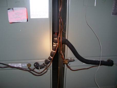

Bill Kibbel Posted October 4, 2007 Report Share Posted October 4, 2007 I inspected a large farmhouse today that had heat pumps retrofitted in the mid '90s. There are 3 condensing units and 4 air handlers/evaporators. Back-up is a propane boiler for hydro. The "twin" air handlers in a basement are connected with a "T" to a single lineset that connects to a single condensing unit. I've never seen this set-up before. I've seen many split ductless ACs and HPs that have 2 or 3 indoor units running off of a single condensing unit, but they all have separate linesets. Anyone else? I was looking forward to seeing this system in action, but the right system wouldn't work on any mode. The condensing unit was 2 tons and the evaporators were each 1.5 ton. Any comments? Quote Link to comment Share on other sites More sharing options...

Terence McCann Posted October 5, 2007 Report Share Posted October 5, 2007 Hey Bill, just got back from a weeks vacation. The wife and I went hiking in Hocking Hills, Ohio. Great scenery - Old Mans Cave, Ash Cave & Cedar Falls to name a few. Beautiful terra-forming caused by retreating glaciers. You were right when you called it "twinned". If you Google "Carrier Twinning Kit" you'll come up with quite a few good links. Two furnaces with one condensing unit. I've only seen two of these systems in action and that was many years ago. Off the top of my head: As long as you have a full column of liquid to the TXV (expansion valve) and as long as the super heat is correct everyone should play nicely (however flow rates through conventional tee's is the problem). I'll keep digging to see what I can come up with for a piping diagram. The twinned systems do work though. Quote Link to comment Share on other sites More sharing options...

Bill Kibbel Posted October 6, 2007 Author Report Share Posted October 6, 2007 Terry, I've heard of Hocking Hills. It's near Columbus right? They're probably the only hills in the state. [:-tong2] I spent some time in OH; Grandma was in Shaker Heights, Niece & Nephew were at OSU, Sister is in Cincinnati & I went to Wittenberg U for a short time. We'll check it out the next time we drive through. Terry & Mike, I'm not up on the science behind refrigeration, but the flow of refrigerant through a "T" is what came into my mind first. I even joked with the buyer and said "how does half the refrigerant know it needs to make a left?" I thought twinning referred to installing 2 systems into a single zone duct system and the "kit" would be the new controls. Quote Link to comment Share on other sites More sharing options...

JEuriech Posted October 6, 2007 Report Share Posted October 6, 2007 If I was to guess, I would think that the type of metering device would determine how well the refrigerant was balanced going to each evaporator. If both metering devices had a fixed orifice, then I would suspect that you would have great difficulty balancing the refrigerant. If both metering devices had thermostatic expansion valves, I don't think you would have a problem balancing both units. I would also be concerned with the size of the evaporators versus the condenser. You have two 1 1/2 ton evaporators (3 tons total) and only a 2 ton capacity condenser. You have the ability to absorb more heat then the condenser can get rid of. I would think that you would now have an unbalanced system that would not run very efficient. Jeff Euriech Peoria Arizona Quote Link to comment Share on other sites More sharing options...
Terence McCann Posted October 6, 2007 Report Share Posted October 6, 2007 Rule of thumb is you can oversize the evap by 1/2 ton. This use to be standard practice for better dehumidification. If you go much larger you run into the problem of not boiling off all the refrigerant and bringing back liquid to the compressor (3 ton evap, 3 ton expansion valve, 2 ton condensing unit). If you used a 3 ton evap with a 2 ton expansion valve then there would be the problem of to high of a superheat coming back to the compressor (to much coil and not enough refrigerant). Quote Link to comment Share on other sites More sharing options...
