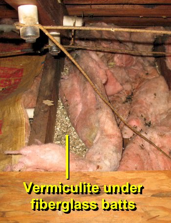

hausdok Posted October 13, 2007 Report Share Posted October 13, 2007 Hi all, About 10 days ago I did a pre-offer inspection for a long-time customer - an environmental attorney, no less. The house wasn't too bad. There were the typical things with a 70-year old house and there was a little bit of asbestos sealing tape in the heating registers, but, overall things looked pretty good. Pretty good, that is, until I got into the attic, where I discovered that beneath about 6 inches of blown-in fiberglass over about another 3 inches of Silva-Wool, the joist bays were full to the tops of the ceiling joists with vermiculite. There'd been absolutely nothing said in the disclosure statement about vermiculite. I recommended that he take a sample and get it tested and then, if it turned out to contain asbestos, to really, really, really think very hard about it before he made up his mind about whether or not to profer an offer on the house. Anyway, that's only part of the story; about 3 hours after I started, another inspector showed up and began inspecting. I stayed out of his way and he out of mine. When I came down out of the attic, I offered the use of my ladder so he could take a look. He passed. A little while later, when I crawled out of the crawlspace, I offered to leave it open for him. He walked over, squatted down in front of the opening, shone his light inside, and then said, "Ok, close it up," and walked away. I just scratched my head, smiled at the client, and went about replacing the hatch, wondering how he was going to possibly know that the insulation at the other end of that crawlspace was all knocked down and destroyed by rodents and that I'd just had to crawl through a puddle of rat urine to get out of there. By the time I'd picked up my gear and had walked around to the front of the house, the other inspector was walking away with his check in hand and his clients were getting in their car with a checklist report in-hand. My clients and I spent about 10 more minutes reviewing everything that they'd been shown, and then I collected my check, took my notes home and the following day sent them the full narrative report. A few days later, I got an email from the client thanking me for the detailed inspection and report. He said that after long hard thought about it, he and his wife had decided to go ahead and make an offer on the house, despite the vermiculite, but that they'd been beaten out by the other couples offer, which was $150,000 more than their own!!!!!????? I wrote him back: "Guess the joke is on the folks who won the bidding. Wonder what their reaction is going to be when they discover that there's enough vermiculite in the attic to fill the bed of a dump truck and that there are a bunch of rats using their crawlspace as winter headquarters, not to mention the other 57 items we found." (His report was 23 pages, 17 of which were actual single-spaced narrative.) Part of me wants to go find that other inspector and slap him upside the head, the other part wants me to drive over to that house and warn the buyers about what's in that attic. I won't do either, of course, but it's hard some days. What's ironic is that my client specializes in Zonolite-related lawsuits. It's ironic that he would have even considered buying a house with the stuff in it, and it's even more ironic that when/if the owner of this house discovers that their house is full of an allegedly dangerous substance that she'll probably end up hiring my client to go back after the listing agent, seller, and, of course, the inspector who couldn't be bothered to inspect an attic or crawlspace. ONE TEAM - ONE FIGHT!!! Mike Quote Link to comment Share on other sites More sharing options...

Jesse Posted October 13, 2007 Report Share Posted October 13, 2007 Forgive me for revealing yet another layer of my ignorance. Mike, you spoke fairly dramatically about vermiculite. I can ID it. I can tell you what it might have in it, and why, and when, blah, blah, blah. I get the impression from you, though, that even undisturbed, it presents a higher risk to occupants than other asbestos-containing stuff. Am I interpreting something wrong? Am I inferring too much from your story? EDUMACATE ME! PS - Loved the story. Kinda how I feel when I tell some body I'm a home inspector, and he/she tells me what a great guy his/her home inspector was. The inspector was there for almost two hours, and found that the kitchen didn't have those outlets with the buttons. "So we got the seller to fix that!" Quote Link to comment Share on other sites More sharing options...
hausdok Posted October 13, 2007 Author Report Share Posted October 13, 2007 No, That's not what I'm saying at all. The attic is full of vermiculite. Then too, there's a possibility that the walls are too and I made him aware of that fact as well. Every time they go into the attic, replace a ceiling fixture, slam a door, fibers in the attic will end up in the air. I don't care what you do, there's virtually no way to fully encapsulate that stuff. Personally, it wouldn't bother me at all, because I think that the only people that get sick from the stuff are those that are already predisposed to getting sick from it, and I doubt that I am - hell, I haven't ever even had a cold. But that's not what this is about - it's about non-disclosure of known issues. For the past 5-6 years the Seattle P.I. has been on a vendetta against W.R. Grace over Zonolite. The amount of media hype they've thrown at the whole asbestos thing has been huge. When they report about it they make is sound like everyone on Puget Sound is under a death sentence. But that's not the issue; as demonstrated, even an asbestos-smart guy might be willing to purchase a home that's got it, but nobody wants to purchase a home without first knowing it's there. Would you? It wasn't disclosed, remember? Yet, as you'll see below, there's no way they couldn't have known it was there. Imagine, if he didn't know it was there, my client trying to sell that house years from now with an attic full of vermiculite when a conscientious inspector found it. Having a home with that much of a suspected carcinogen in it is like wearing an anchor around your neck. My clients weren't smiling when we got done, but they weren't wigging out either. They knew what they had and they had to go home and think about it before deciding what to do. However, thanks to Mr. Lazy Inspector, his clients were all smiles as they walked away. you can bet that they have no idea what's in that attic and that's why their offer was so amazingly high. What do you suppose they're going to feel like when they realize what they've bought. By the way, this stuff was disturbed. I forgot to mention that some genius had decided that it would be nice to add a skylight. In the process of doing so, they'd shoveled all that insulation out of the way, installed the skylight, built a chase, and then raked all of the insulation back around the chase, stirring up about 20% of what was there in the process. So, that the vermiculite was all interspersed within the insulation from the top two layers. ONE TEAM - ONE FIGHT!!! Mike Quote Link to comment Share on other sites More sharing options...

hausdok Posted October 13, 2007 Author Report Share Posted October 13, 2007 Hi, Well, I suppose I should have titled this thread "Rat Crap" or "Lazy Inspectors" because whereas I'm trying to make a point about inspectors who're screwing their clients by being lazy asses, you guys insist on getting wrapped around the axle about the vermiculite, which is important, but was not the point of the post. For the record, I always assume that this stuff, and all of the other stuff besides vermiculite that's supposed to have asbestos that I see and make clients aware, has asbestos and I tell them to assume the same. That doesn't mean I'm going to stop recommending that folks rely on a reputable IAQ lab to do they best they can to verify what the stuff is and help folks deal with it. I'd rather do that than leave them twisting in the wind trying to interpret a whole lot of crap on the internet or the sensationalized stuff that they're reading in the P.I. I don't recommend folks to anyone who solicites my business through emails and who's allied with questionable public relations firms trying to pass themselves off as reputable organizations - I refer them to a pretty reputable lab that's been around about 20 years. Those people working in that lab are a whole lot more familiar than I am with asbestos, lead, and any other environmental mess. I know that they'll take care of them, including advising them that testing is or is not reliable - that's why I send my clients to them. Think I'll change the title of the rant now. How's "Inspectors With Their Heads Up Their Butts" sound? ONE TEAM - ONE FIGHT!!! Mike Quote Link to comment Share on other sites More sharing options...
