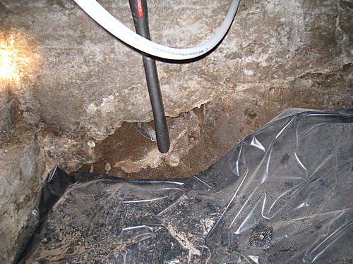

Chris Bernhardt Posted October 25, 2007 Report Share Posted October 25, 2007 What's the recommendation on undercut foundations? What about the situation where someone has excavated vertically next to the footer with in the cone of compression? Image Insert: 85.99 KB Chris, Oregon Quote Link to comment Share on other sites More sharing options...
kurt Posted October 25, 2007 Report Share Posted October 25, 2007 First, underminement isn't a word, or at least it isn't in my dictionary. Digging out under a footing is bad. Shouldn't do it. Honest, though, it's a real common practice around here when digging out bsmt's. for added square footage. Heck, I've dug under the footing of my solid load bearing masonry 1 1/2 story bungalow a width of 3 feet to run a sewer line; it works fine. You won't catch me recommending it to customer's, but it happens all the time. I see lots of jobs where the damn footing is completely removed, and the house hangs there by skyhook, while the contractor excavates, places a new footing, then forms up and places a new concrete foundation under the old one to bear on the new footing. Sounds scary, doesn't it? It's not, but it ain't for the faint hearted. They're just single family houses. We used to build them up, tear them down, move walls around, rebuild foundations, and do all sorts of stuff that might make the inexperienced freak out and call for review by a structural engineer, but years ago, everyone understood how houses work, and no one ever called an engineer for anything, and nothing unexpected or bad ever happened. I wish I had an inspection school. I'd have an old house, and we'd take a week taking out load bearing walls, cutting holes in the foundation, or otherwise doing all sorts of evil stuff to see what actually happens, and to experience viscerally what forces are at work. I think most folks would be surprised how simple it really is. Nothing falls down quickly; stuff falls down very, very slowly. A little alteration here or there isn't going to mean a hill of beans in most cases. That said, if I saw your picture condition on an inspection, I'd certainly write it up as needing "repair", mostly because there's always some contractor to come in and tell folks there house is going to fall down if they don't fix the footing. (didn't your inspector tell you about this!!??!) I'd do it to cover my butt. On a practical level, though, I don't think that little bit of missing footing is going to do anything other than just sit there like it is now. Quote Link to comment Share on other sites More sharing options...
randynavarro Posted October 25, 2007 Report Share Posted October 25, 2007 I don't make an issue of a single point excavation like that. I'm not an engineer but common sense tells me that the concrete stem wall is, in essence, spanning or bridging the gap--it's a mini bridge. Concrete's very strong in compression like that; even more so if there's re-steel inside. Lots of sump pump and gravel-filled trenches in these parts. If I see one where they've dug too close to the "cone of compression" (I've never used that term before, but its cool) I'll write it and recommend they have it fixed. That type of work also implies the people that did the gravel drain system probably don't have much experience either. How do you fix a continuously undermined section of footing? Not sure. Its not like you can just dump some soil back in and get the necessary compaction with a machine in a tight space like that. Anyone else? Quote Link to comment Share on other sites More sharing options...
Chris Bernhardt Posted October 25, 2007 Author Report Share Posted October 25, 2007 Thanks Kurt and Randy. But does anyone know the proper way to correct it? Can you just rebuild it back up compacting it by hand or do you dig it out and pour more concrete? Chris, Oregon Quote Link to comment Share on other sites More sharing options...
Bain Posted October 25, 2007 Report Share Posted October 25, 2007 Very sage, Kurt. Very sage. One of the beams in my eighty-five year old bungalow had been completely decimated by termites, but end result? The floors were a little out of kilter and a couple of the door jambs were an inch or so out of square. I've since reinforced everything to make certain stasis is attained, but the termites took their best shot and the old girl has held up pretty well. Chris, I don't think there really is a feasible repair for the footer in your photo, at least not one that would actually provide any support. Unless, of course, a structural repair company injected concrete to serve as a pier beneath the footer. But that would be totally unnecessary. Quote Link to comment Share on other sites More sharing options...
Jim Katen Posted October 25, 2007 Report Share Posted October 25, 2007 Originally posted by Chris Bernhardt Thanks Kurt and Randy. But does anyone know the proper way to correct it? Can you just rebuild it back up compacting it by hand or do you dig it out and pour more concrete? Chris, Oregon You can pump concrete in there, or even slurry. For a small section, you can dry-pack it with grout. Works great. Alternatively, you can fill the hole with clean sharp rock or river rock. It'll fill the void, it won't settle and it'll prevent the sides of the opening from eroding. But if it's just a small section, 2-3 feet say, I wouldn't bother fixing it. It just isn't a real problem. Now if someone's excavated beside and below the footing for a significant distance, that's a problem. Particulary if they've done it to accommodate a drain tile. The soil under the footing will slowly erode away. (Are you familiar with the term, "mass wasting?") -Jim Katen, Oregon Quote Link to comment Share on other sites More sharing options...

Brandon Chew Posted October 26, 2007 Report Share Posted October 26, 2007 I wouldn't call for an engineer for a problem like Chris posted in the top photo. I'd call a foundation contractor to fix it. Jim covered the repair methods pretty well. While a small section of the foundation that bears an evenly distributed load might not be a problem, if the void was below a load path that was applying a concentrated point load on the foundation from above, it could be trouble. Excavating in the cone of compression along a footing is dangerous stuff. Depending upon the soil type and moisture content, it could give away suddenly causing a collapse. It'll look fine right up until the time that it isn't. Quote Link to comment Share on other sites More sharing options...
kurt Posted October 26, 2007 Report Share Posted October 26, 2007 Originally posted by inspecthistoric Or you can hire a waterproofer to make sure that every last bit of earth gets pulled out from under the foundation. That looks like what I was talking about; it looks like all the soil is removed from under the foundation. Is that what the pic shows? Why doesn't it collapse? Quote Link to comment Share on other sites More sharing options...

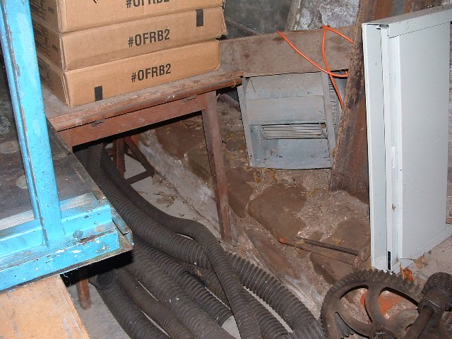

Chad Fabry Posted October 26, 2007 Report Share Posted October 26, 2007 Preventing settlementatude with foundation benching. Image Insert: 85.03 KB Image Insert: 111.1 KB Quote Link to comment Share on other sites More sharing options...

Chris Bernhardt Posted October 27, 2007 Author Report Share Posted October 27, 2007 Using my little engineering brain I agree with Jim K. I can't see why, assuming that the errosion is simple, one couldn't just recompact the ground underneath and adjacent to the footer with dry concrete and gravel and even earth? Now if there were clues that the ground was settling under the footer that would be a different story. Has anyone here ever been told that recompacting this way is a bad Idea? Chris, Oregon Quote Link to comment Share on other sites More sharing options...
StevenT Posted October 27, 2007 Report Share Posted October 27, 2007 A couple of years ago I had to underpin a section of foundation about 40' long. We were dropping a basement floor about 2 feet. I dug out an approximatly 2 foot sections spaced approximatly 6 feet apart and well past the exterior of the foudation. The hole extended about 3 feet lower than the new floor level and was "belled" on the bottom. I then formed in the void and poured concrete high enough to encapsulate the old foundation by about 12 inches. One section of the old foundation had collapsed (in prior years), I jacked up that section prior to encasing it in the form. A few weeks later after stripping the forms I dug out in between my retrofitted footings. Although at these locations I did not excavate quite as much. I then built forms and underpinned the remaining areas. All held very well. Chad, don't you mean settlementatudation? Quote Link to comment Share on other sites More sharing options...

jfmann Posted February 22, 2011 Report Share Posted February 22, 2011 As to undermining shown in photo.......which is relatively minor......simply fill in void with concrete. Any such condition should always be noted in an inspection report. To lower basement floor.....basic approaches are; (1) Bench wall, if loss of space for new (lower) floor is workable, or (2) Underpinning existing wall / footing with new concrete. I have been called out on several foundation collapses caused by contractors exposing too much soil along foundation walls........trying to underpin a wall and installing a drain line. In one case, the contractor explained how, suddenly, a very large segment of thick stone wall "exploded" into the basement, nearly crushing himself and coworker.........he was obviously shaken and would not go back into the basement to install heavy timber shoring that was eventually installed (by others) to allow for major repair work. In another case, the base of a long concrete foundation wall simply slipped inward and downward into the basement, breaking away near each end. Amazingly (though this happens), the wood-framed house wall remained intact, although it did sag about 2 inches. The wall essentially acts as a "deep beam" (at least for a while!) Quote Link to comment Share on other sites More sharing options...
