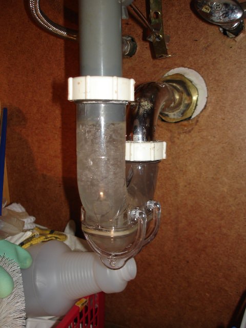

Eric B Posted December 19, 2007 Report Share Posted December 19, 2007 This was as close as I've seen. Image Insert: 152.17 KB Quote Link to comment Share on other sites More sharing options...
