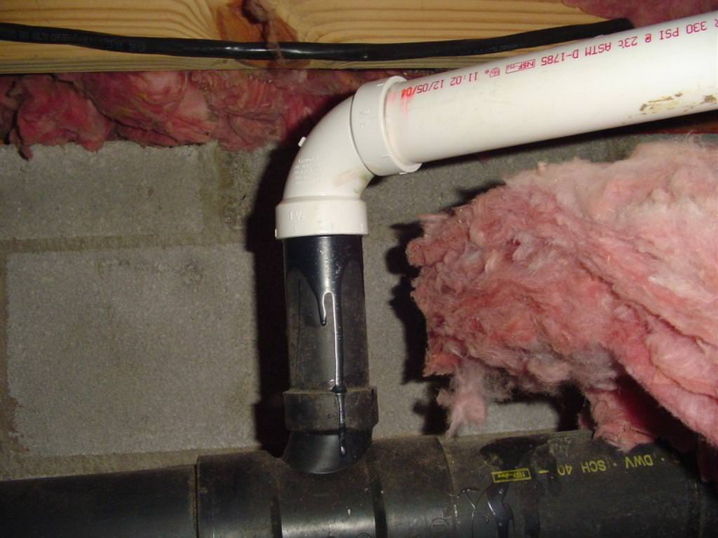

Bain Posted January 12, 2008 Report Share Posted January 12, 2008 I checked out an older house this week that had a bunch of PVC and ABS drain lines glued together. I said they were wrong. The buyer, though, calls yesterday and says his plumber took a look and thought the proper "transition glue" had been used. Fishy? Yes. But I can't honestly say that I'd recognize proper or improper "transition glue." I heard in a CE class early last year that some company had created a glue that would, indeed, meld ABS and PVC, but that the glue hadn't been approved for use, yet. What do youse guys do when you see ABS and PVC glued together? Quote Link to comment Share on other sites More sharing options...
fqp25 Posted January 12, 2008 Report Share Posted January 12, 2008 They do make a "General Purpose Glue" that will weld PVC & ABS to themselves, but to one another is not recommended. I believe because ABS & PVC have different expansion & contraction rates. I've found when there are 2 different plastics in a plumbing system it's usually a hack "Handyman" job. Image Insert: 141.58 KB Quote Link to comment Share on other sites More sharing options...

Chris Bernhardt Posted January 12, 2008 Report Share Posted January 12, 2008 Are you talking about the grey pipe and the white fittings? The grey is PVC; ABS is black. No, transition glue is not approved for use within the footprint of the house. Under the Uniform Plumbing Code your right and the plumber is wrong. If that's a drain, it's messed up. Chris, Oregon Quote Link to comment Share on other sites More sharing options...
Bain Posted January 12, 2008 Author Report Share Posted January 12, 2008 That's Frank's photo, Chris. I was talking about this kind of t'ing. I know it's wrong, but was wondering if the plumber who came in behind me was aware of something I wasn't. Image Insert: 103.79 KB Quote Link to comment Share on other sites More sharing options...

charlie Posted January 12, 2008 Report Share Posted January 12, 2008 From the IRC: P3003.2 Prohibited joints. Running threads and bands shall not be used in the drainage system. Drainage and vent piping shall not be drilled, tapped, burned or welded. The following types of joints and connections shall be prohibited: 1. Cement or concrete. 2. Mastic or hot-pour bituminous joints. 3. Joints made with fittings not approved for the specific installation. 4. Joints between different diameter pipes made with elastomeric rolling O-rings. 5. Solvent-cement joints between different types of plastic pipe.6. Saddle-type fittings. Quote Link to comment Share on other sites More sharing options...

Jim Katen Posted January 13, 2008 Report Share Posted January 13, 2008 You can use transition cement to join one type of piping *system* to another *system*. For instance the DWV piping in the house might be ABS plastic and the sewer pipes might be PVC. Transition cement can be used to connect the DWV system to the sewer system. That's what transition cement is intended to be used for. A couple of years ago, I did an experimetnt for the Oregon Association of Home Inspectors. I made up about 24 fittings using combinations of ABS and PVC pipe glued to each other with every combination of correct and incorrect cement products that I could find. I then sawed each connection in half to examine the finished joints. Some looked better than others but they were all strong joints. At the next meeting, I passed out the pieces to the membership along with hammers, pliers and vice grips and invited them to destroy the connections. I wanted to see which fittings failed and how they failed. By the end of the evening, not a single joint failed. They all broke at the point where the pipe met the fitting, but the cemented surfaces remained glued to each other in every case. This included PVC glued to PVC with ABS cement and vice versa. - Jim Katen, Oregon Quote Link to comment Share on other sites More sharing options...
