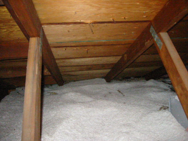

Inspectorjoe Posted March 16, 2008 Report Share Posted March 16, 2008 This morning I had a 1963 ranch that had 3.5 inches of fiberglass batt attic insulation. Thrown/blown/placed on top of that is what at first glance looks like polystyrene pellets. It's not polystyrene, because when you rub it between your fingers, it turns to powder like UFFI. Can anyone identify this stuff? Image Insert: 161.31 KB Image Insert: 193.78 KB Link to comment Share on other sites More sharing options...
Jim Katen Posted March 16, 2008 Report Share Posted March 16, 2008 Perlite? - Jim Katen, Oregon Link to comment Share on other sites More sharing options...
Brandon Whitmore Posted March 16, 2008 Report Share Posted March 16, 2008 Looks like perlite to me too. They use it in greenhouses to mix in with potting soil, etc. (I don't think it has a high R- value, but could have just been lying around). Link to comment Share on other sites More sharing options...
Inspectorjoe Posted March 16, 2008 Author Report Share Posted March 16, 2008 Bingo! Thanks Jim & Brandon. Perlite.net Now can anyone identify this product that I found in the same house? [] Image Insert: 208.21 KB Link to comment Share on other sites More sharing options...
