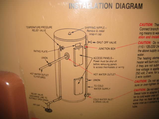

jodil Posted April 24, 2008 Report Share Posted April 24, 2008 Is it necessary to remove the shipping nipple and replace with the plastic cap per manufactures instructions? What if you dont? Then what? Thanks Link to comment Share on other sites More sharing options...
jodil Posted April 24, 2008 Author Report Share Posted April 24, 2008 In case you dont know what it looks like here it is: Image Insert: 51.33 KB Link to comment Share on other sites More sharing options...
Jim Katen Posted April 24, 2008 Report Share Posted April 24, 2008 Originally posted by jodil Is it necessary to remove the shipping nipple and replace with the plastic cap per manufactures instructions? What if you dont? Then what? Thanks I don't know. None of the water heaters I've installed ever came with shipping nipples. The thing in your photo doesn't look like galvanized steel. Is it bare steel? Does the top have female threads? Looks strange. - Jim Katen, Oregon Link to comment Share on other sites More sharing options...

fqp25 Posted April 24, 2008 Report Share Posted April 24, 2008 That looks very strange. Never seen a female nipple before, or what ever that is. It could be some kind of dielectric nipple, but you should see a little bit of plastic on top, so I doubt it. The only time I've seen nipple shipped, were for big 100 gallon commercial WH. Those usually came with 1-1/2" Dielectric Nipples, but male ends on both sides. Also they just came with the WH, never installed. Could damage the inner threads. That WH might have been returned, then resold. As Jim said it doesn't look like regular galv, but it could be chromed. Almost makes you want to read the manual. (Oh no not that!!!) Frank Link to comment Share on other sites More sharing options...
fqp25 Posted April 24, 2008 Report Share Posted April 24, 2008 I think I misread your first post. Is that thing inside an outlet or inlet? Plastic cap? Is that where the anode rod is suppose to go? Frank Link to comment Share on other sites More sharing options...
jodil Posted April 24, 2008 Author Report Share Posted April 24, 2008 Women always read the manuals frank Well kinda... No, it has no threads, and the plastic cap is still taped to the top. I read the instruction label on the side of the 14 year old 80 gallon unit: Image Insert: 48.97 KB Link to comment Share on other sites More sharing options...
Richard Moore Posted April 24, 2008 Report Share Posted April 24, 2008 Looks like something with no more purpose than to keep it centered in the shipping box. As it's just a "snap-in" plastic cap and, obviously, it doesn't actually penetrate the tank, I can't believe there would be any harm in leaving it there. Besides, it will make a nice handle to drag it out when they replace the 14 year old unit. Link to comment Share on other sites More sharing options...
