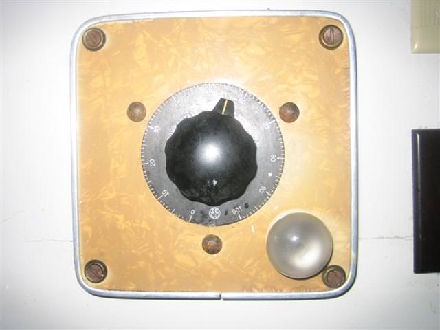

inspecmoore Posted April 26, 2008 Report Share Posted April 26, 2008 Has anyone seen one of these? It was located in the kitchen of a house that was built in 1940. It was still operational, but I was not sure what it's purpose was. Powerstat was written on the face. Image Insert: 37.16 KB Quote Link to comment Share on other sites More sharing options...
jon_ran Posted April 26, 2008 Report Share Posted April 26, 2008 looks like a timer Quote Link to comment Share on other sites More sharing options...
hausdok Posted April 26, 2008 Report Share Posted April 26, 2008 Looks like an old version of a line thermostat. OT - OF!!! M. Quote Link to comment Share on other sites More sharing options...
ghentjr Posted April 26, 2008 Report Share Posted April 26, 2008 Originally posted by inspecmoore Has anyone seen one of these? It was located in the kitchen of a house that was built in 1940. It was still operational, but I was not sure what it's purpose was. Powerstat was written on the face. Image Insert: 37.16 KB http://www.superiorelectric.com/POWERSTAT.htm Quote Link to comment Share on other sites More sharing options...
jon_ran Posted April 26, 2008 Report Share Posted April 26, 2008 Originally posted by hausdok Looks like an old version of a line thermostat. OT - OF!!! M. That was my first thought, but I have never seen one go from 0-100. Could it be a rheostat for speakers or lighting? Quote Link to comment Share on other sites More sharing options...
Jim Katen Posted April 26, 2008 Report Share Posted April 26, 2008 Originally posted by inspecmoore Has anyone seen one of these? It was located in the kitchen of a house that was built in 1940. It was still operational, but I was not sure what it's purpose was. Powerstat was written on the face. As John pointed out, it's a variable autotransformer. It would have been used for dimming lights or anything else that relies on variable voltage (such as a DC motor). It would not have been used on an AC motor. How do you know that it was still operational if you don't know what it controlled? Look for a largeish bank of lights or a DC motor. Auto transformers are robust and long lived, but they do eventually break down when the insulation on the windings fails. At that point, you'll just get line voltage all the time, no matter where the brushes are on the coil. - Jim Katen, Oregon Quote Link to comment Share on other sites More sharing options...

inspecmoore Posted April 26, 2008 Author Report Share Posted April 26, 2008 Originally posted by Jim Katen Originally posted by inspecmoore Has anyone seen one of these? It was located in the kitchen of a house that was built in 1940. It was still operational, but I was not sure what it's purpose was. Powerstat was written on the face. As John pointed out, it's a variable autotransformer. It would have been used for dimming lights or anything else that relies on variable voltage (such as a DC motor). It would not have been used on an AC motor. How do you know that it was still operational if you don't know what it controlled? Look for a largeish bank of lights or a DC motor. Auto transformers are robust and long lived, but they do eventually break down when the insulation on the windings fails. At that point, you'll just get line voltage all the time, no matter where the brushes are on the coil. - Jim Katen, Oregon I couldn't find anyhting which was operated by the powerstat, it could be turned on by a push button switch on the other side of the wall, and the bulb at the bottom right hand corner would get brighter as the dial was turned to the right. I talked to an electrician friend of mine who thought it probably controlled a fan or vent which was no long in place. Thanks for the replies. Quote Link to comment Share on other sites More sharing options...

Jim Katen Posted April 26, 2008 Report Share Posted April 26, 2008 Originally posted by inspecmooreI couldn't find anyhting which was operated by the powerstat, it could be turned on by a push button switch on the other side of the wall, and the bulb at the bottom right hand corner would get brighter as the dial was turned to the right. I talked to an electrician friend of mine who thought it probably controlled a fan or vent which was no long in place. Thanks for the replies. It probably didn't control a fan. That thing varies the voltage, so if you tried to connect it to an AC motor load, you'd destroy the motor pretty fast. If we're talking motors, you'd use this kind of dimmer for a DC motor that you wanted very fine control of over a broad range. It would be good for a model railroad or a winch or something like that. However, in a 1940s kitchen, it's more likely that it controls some sort of fairly heavy resistance load. Think along the lines of a bank of lights or a stand-alone broiler coil. - Jim Katen, Oregon Quote Link to comment Share on other sites More sharing options...
hausdok Posted April 26, 2008 Report Share Posted April 26, 2008 Hi Jim, Did you check out the link that John Ghent posted above? It looks like some of those were designed to run DC loads and others to run AC loads. OT - OF!!! M. Quote Link to comment Share on other sites More sharing options...
Jim Katen Posted April 26, 2008 Report Share Posted April 26, 2008 Originally posted by hausdok Hi Jim, Did you check out the link that John Ghent posted above? It looks like some of those were designed to run DC loads and others to run AC loads. OT - OF!!! M. Where did you find that? I don't see it. - Jim Katen Quote Link to comment Share on other sites More sharing options...
hausdok Posted April 26, 2008 Report Share Posted April 26, 2008 Look at Type Q116. Quote Link to comment Share on other sites More sharing options...
Jim Katen Posted April 27, 2008 Report Share Posted April 27, 2008 Originally posted by hausdok Look at Type Q116. I've looked. Where does it say you can use this to control an AC motor? - Jim Katen, Oregon Quote Link to comment Share on other sites More sharing options...

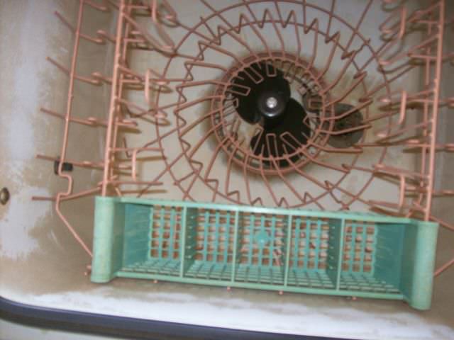

mridgeelk Posted April 28, 2008 Report Share Posted April 28, 2008 Tim, I tried to send this as a private message as it is a bit off topic but couldn't figure how to load the picture. I found this dishwasher, possibly designed by a former Evinrude engineer, in a state of the art 1957 kitchen just west of Hotchkiss. It was the only thing in the kitchen that didn't work. Originally posted by inspecmoore Has anyone seen one of these? It was located in the kitchen of a house that was built in 1940. It was still operational, but I was not sure what it's purpose was. Powerstat was written on the face. Image Insert: 37.16 KB Image Insert: 320.02 KB Quote Link to comment Share on other sites More sharing options...
