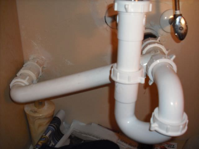

NJinspector Posted April 27, 2008 Report Share Posted April 27, 2008 The pipe to the left is coming from the slop sink in a utility closet. This line is already trapped in the closet. What is stopping the water from the sink to back right into the other sink? Plus the improper slope of the line on the left. Somehow, both sinks are draining fine. Just doesnt look right to me. Image Insert: 120.91 KB Link to comment Share on other sites More sharing options...
John Dirks Jr Posted April 27, 2008 Report Share Posted April 27, 2008 What's the level of the bottom of the slop sink in relation to the level of the bottom bathroom sink? Link to comment Share on other sites More sharing options...
hausdok Posted April 27, 2008 Report Share Posted April 27, 2008 That pipe is forming a really, big trap is all. OT - OF!!! M. Link to comment Share on other sites More sharing options...
Jim Katen Posted April 27, 2008 Report Share Posted April 27, 2008 Originally posted by hausdok That pipe is forming a really, big trap is all. OT - OF!!! M. Exactly. Everything below the weir is full of water. The underwater portions won't scour and, depending on what you put down both sinks, stuff could settle out in the pipes. It's not the end of the world, but it ain't kosher. - Jim Katen, Oregon Link to comment Share on other sites More sharing options...
jon_ran Posted April 27, 2008 Report Share Posted April 27, 2008 Great big double trap, not allowed. Link to comment Share on other sites More sharing options...
