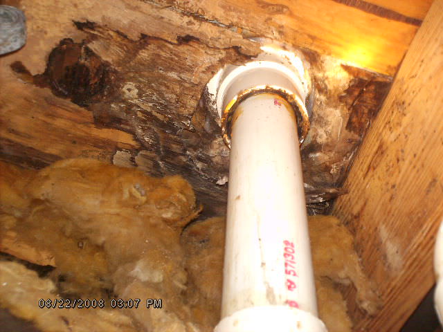

Phillip Posted August 24, 2008 Report Share Posted August 24, 2008 Can a shower pan be properly repaired without tearing out all of the tile? Image Insert: 76.56 KB Image Insert: 105.72 KB Quote Link to comment Share on other sites More sharing options...
Scottpat Posted August 24, 2008 Report Share Posted August 24, 2008 No, not in my opinion. I have seen some attempts and they have always looked bad and still leaked. I have seen some that the owners had epoxy or something similar poured over the entire shower floor and then brushed up the sides a few inches. Looks like they have placed the entire shower floor under a plastic sheet.. Quote Link to comment Share on other sites More sharing options...
Billy_Bob Posted August 24, 2008 Report Share Posted August 24, 2008 I'd rip that all out and start by replacing the wood flooring in that area. Then let's see... The tile probably goes up the wall too, then couldn't get tile to match. So then replace that tile too, etc... Quote Link to comment Share on other sites More sharing options...
kurt Posted August 25, 2008 Report Share Posted August 25, 2008 That isn't even a shower floor drain receptor; it's just a floor drain. Lacking vinyl pan liner and a proper receptor, it can't work. Can't. Tear it all out and start over. I'm seeing this problem on high end houses nowadays. No one knows how to install a mortar bed shower anymore. Quote Link to comment Share on other sites More sharing options...

Phillip Posted August 25, 2008 Author Report Share Posted August 25, 2008 It looked like crap to me but I was just checking to see if there was a way to do it with out tear it completely out. I report it as not proper and recommend that they get some in there that knew what they where doing. Quote Link to comment Share on other sites More sharing options...

Phillip Posted August 25, 2008 Author Report Share Posted August 25, 2008 Well I went back to the house the day to test the shower head since it was turn off. (See my other post) The water came out of the shower head just fine and I filled up the shower pan and it leaked. I was not surprised. The pilot light was off on the furnace and they had it on. It needs replaced Friday and it still needs replaced today. Major rust, movement of the flames Crack in Chamber) and a 1978 model. Quote Link to comment Share on other sites More sharing options...
